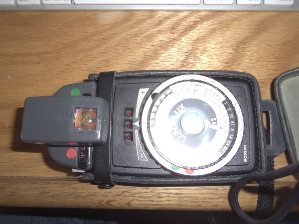

I'd read it and interpret but busy with other things right now. Sorry. Look at the pic of the dial. The yellow diamond is for a straight reading. The other two circles are for the 7.5/15 attachment. I think they are 3 EV and 5 EV offset. That is my recollection also... but it is an older recollection. Also, My attachment is older than yours and does not have that sticker. I use the dial on a (regular) Luna Pro. Check it out to make sure I'm not inadvertently deceiving you. :smile:
I added red and green dots on the meter and the attachment to remind me about the EV offsets.

I seem to recall that there are two versions of the vari-angle attachment: gray and black. Mine is gray and has no offset sticker. The other is black and had an offset sticker. I can't recall if they are the same or different. I'd guess the same, but that is just a guess. There seem to be several different dial configurations with different offsets, depending on the vintage of the meter. My recollection is that the gray vari-angle went with the old gray luna pro (the gear I use). I also have a vague recollection that the black vari-angle went with the SBC... but I could be all wrong on that. I think the trick is to get the two pieces of equipment to be from the same vintage. But if your SBC doesn't match the SBC manual... then I'd be totally befuddled!

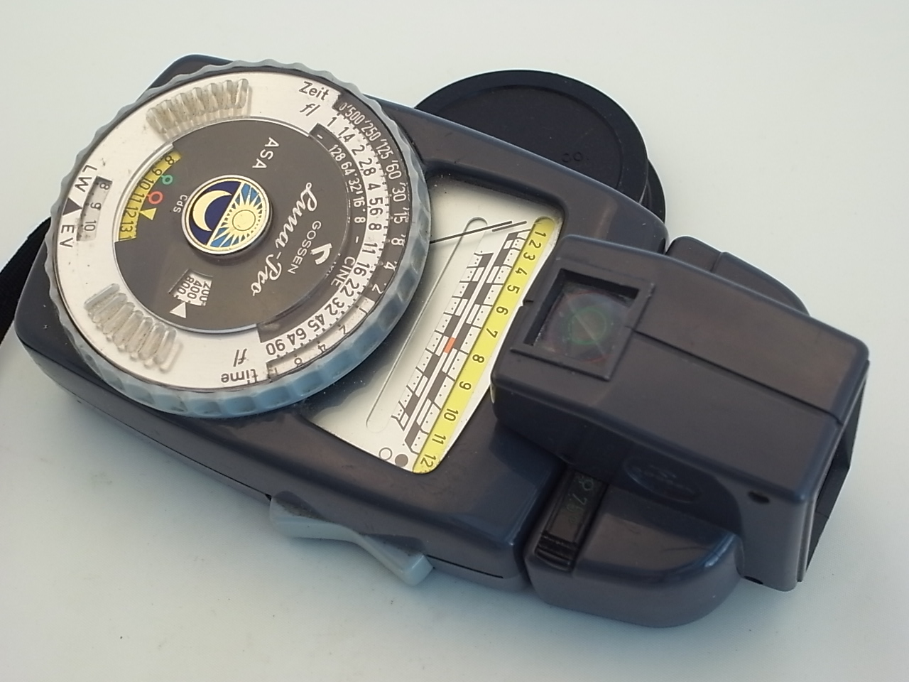

Here is my original Luna Pro meter with the spot attachment on it. You will notice on the bottom of the setting dial the arrow with the two circles next to it, the circles colored red and green. The arrow is used for setting the dial when using the meter alone in reflected light use. The circles are where you set the dial when using the spot attachment. The spot attachment has matching colors both on the circles that you view through and the writing of the angles used (7.5 and 15 degrees) to remind you which colors to set the dial to. I think that the settings give a full compensation so that the meter gives the same readings but I haven't tested it to prove it. Something I will do in the next few days. Bob.
Thanks, Bob. I've gotten a number of responses cueing on the the coloured dots. (which, to paraphrase Henry Reed's poem, The Naming of Parts, "in this case, I do not have") It seems clear that the attachments are calibrated across certain models in the SBC family, but less clear that it is universal to all models. As RobC suggests, I have done done enough work to fit the spot attachment into my process, regardless of what the published numbers may be. What I had been hoping for was some explanation of why my readings are consistently +1 EV off. I was convinced that for some reason, my observations were flawed, and that I was missing some underlying logic in setting, reading or interpreting my devices.
