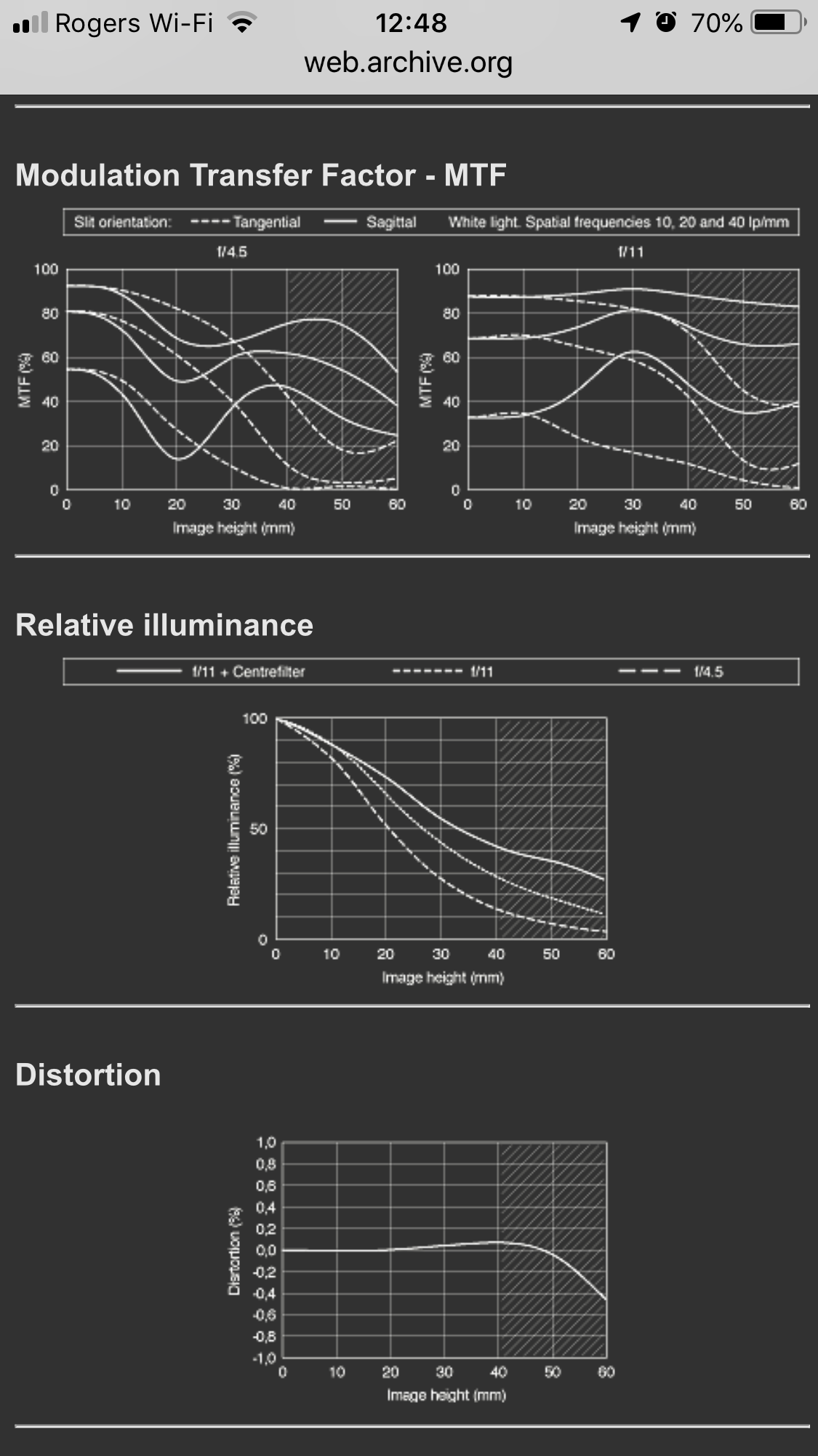

I think that’s what I may be seeing. Here’s the mtf for the 35mm lens which shows an increase of sharpness moving away from center. Would this explain it ?
Most likely you are seeing focus shift as the lens is stopped down, and field curvature differences between the lenses. Different optical designs behave differently. If you focused stopped down the DOF would likely be very close, but focus curvature will likely be different.
Notice that at f/11 the center sharpness falls a bit but there's a huge gain half way to the corner. That is almost certainly focus shift. Try focusing away from the center wide open. When you stop down you should get a more balanced focus. Or you can figure out the degree of shift experimentally and correct focus based on that.
