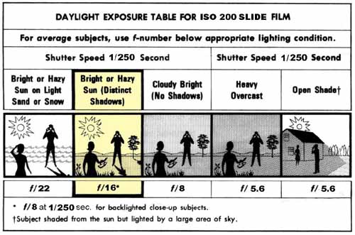

Remember these from the 35mm filmboxes?

It's a missing historical context thing. People forget that the exposure charts and cameras in the 1800s were just as cutting-edge high tech in their day as the most modern meters and cameras are today. They only look quaint and simple to us because we now look back at them from the distant future.
The use today of a camera with modern metering is no different in principle to the use by someone in the 1800s of a pre-calculated and highly detailed photographic exposure chart. Both were the best and most complex tools of their time and the wonders of their day. Both required similar wrestling matches to master and use correctly.
But their respective degrees of difficulty, relative to their historical contexts, were about the same. As will be the respective degree of difficulty of our tools, when those 140 or so years from now look back at us and ask pretty much the same questions. Only the tools will differ.
