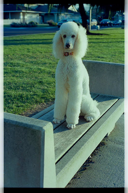

Hi,
I'm new to color development and have had a few successful rolls now using the Digibase chemicals. With the help of this group, I've actually gotten pretty happy with what I'm getting.
I developed a roll of Ektar today and noticed a bit of a green/blue cast on the positive scans and I was wondering what I should be learning from it. My process is to scan using Vuescan using the feature where you can lock the color of the film base. In this case, the DNGs generated come into my software at 6500K with +10 magenta on the tint. I found that if I bump the whole roll to 7500K with +30 magenta things seem to look generally better.
I wondered if this is the result of my technique still being a bit rough or if this is just the tolerance of negatives under mixed light? The shot I'm attaching is under late afternoon sun. Would shooting a frame of a gray card help getting a sense of how far off my color balance is?
I don't have a lot of experience with C-41 in general, I've done more black-and-white and chrome work, so I'm not sure what to expect.
Thanks for all the help,
Jonathan
Edit: I'm processing using a stainless steel tank, manually agitated. This is the third roll or so that's been processed with this batch of developer.

Shoot a grey card and the MacBeth color chart until you get your processing and printing/scanning refined. The orange mask should indeed print as grey, but alas it does not contain dyes produced in the color layers, and therefore your processing may well (read that as always does) produce a color difference from neutral grey. With a grey card you can read the difference with a color analyzer, or you can use the scan data as an after-the-fact color analyzer.

I wonder if the cyan cast is from the orange base on the neg? The cast doesn't show on color paper, but might in scans.

Your shot looks fine to me. Vuescan has a tendency to pick color balance for you. And often not very successfully. It also tends to screw up the Ektar most impressively because of the film's high saturation. In this shot, bench makes a wonderful gray card. Click on it to set color balance and you may get a reasonable shot. This jpg color balances just fine for me in an editor.
By now you know why most of us here don't particularly enjoy hybrid approach :smile:. Just print this shot under the enlarger and you'll get a beautiful portrait of a snow-white dog. Your model is super cute by the way!

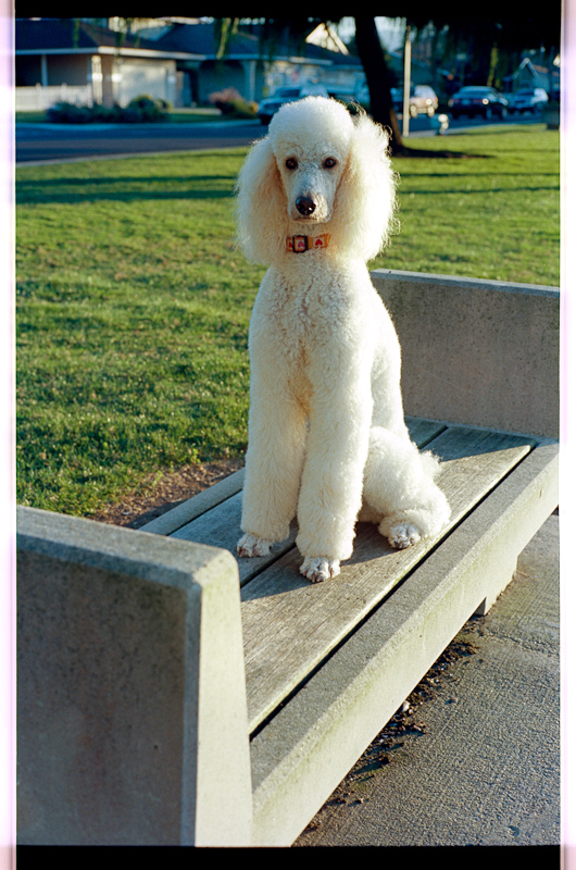

Its just your scannersoftware that doesnt doe the job for you. I Have adjusted and color balanced it for you very quick in curves. If you make a quality scan with proper software, the colourcast will disapear.

1) I'll shoot some test images of a gray card. What am I looking for there? It should look gray, but is that useful for anything other to set the white point on a scan? Or can I tell by how far it is off of 6500K how I should correct the roll? If the orange mask should be gray, what does a gray card look like?
A portion of the orange mask is "clear" film and can be used as a starting point to set enlarger filtration to yield neutral grey. You can set a color analyzer or scanner to a starting value this way. Initial filtration found this way is going to be close only if the lighting, processing, and film characteristics are entirely correct which they normally are not. If you expose one frame on each roll with an image of the 18% grey card, or something you wish to call neutral grey--cardboard, a painted card, etc.---then you have something to set your filtration to print/scan/analyze as grey and thereby set filtration. DarkMagic demonstrated this quite well by using the bench color as "grey" in the image.
