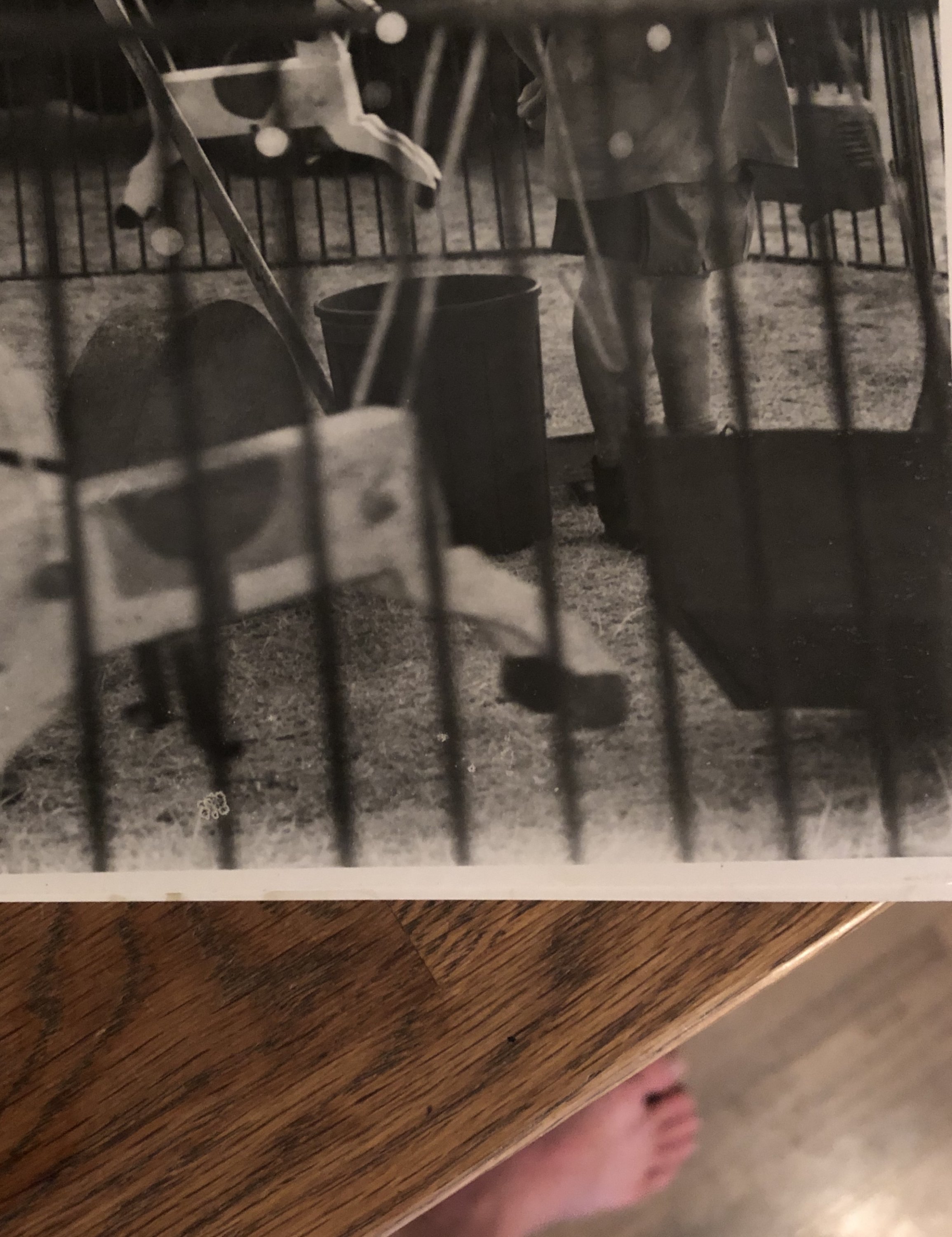

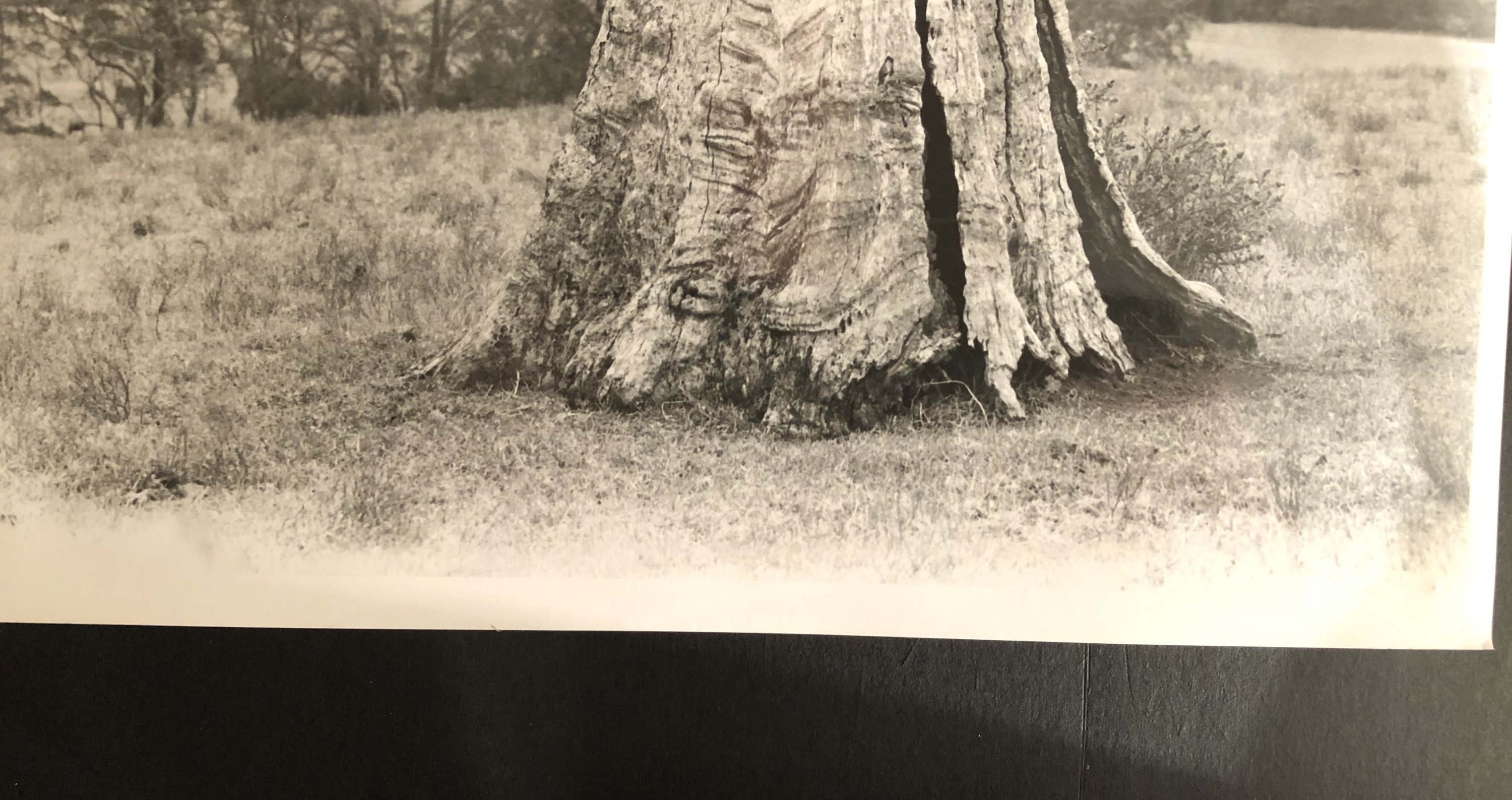

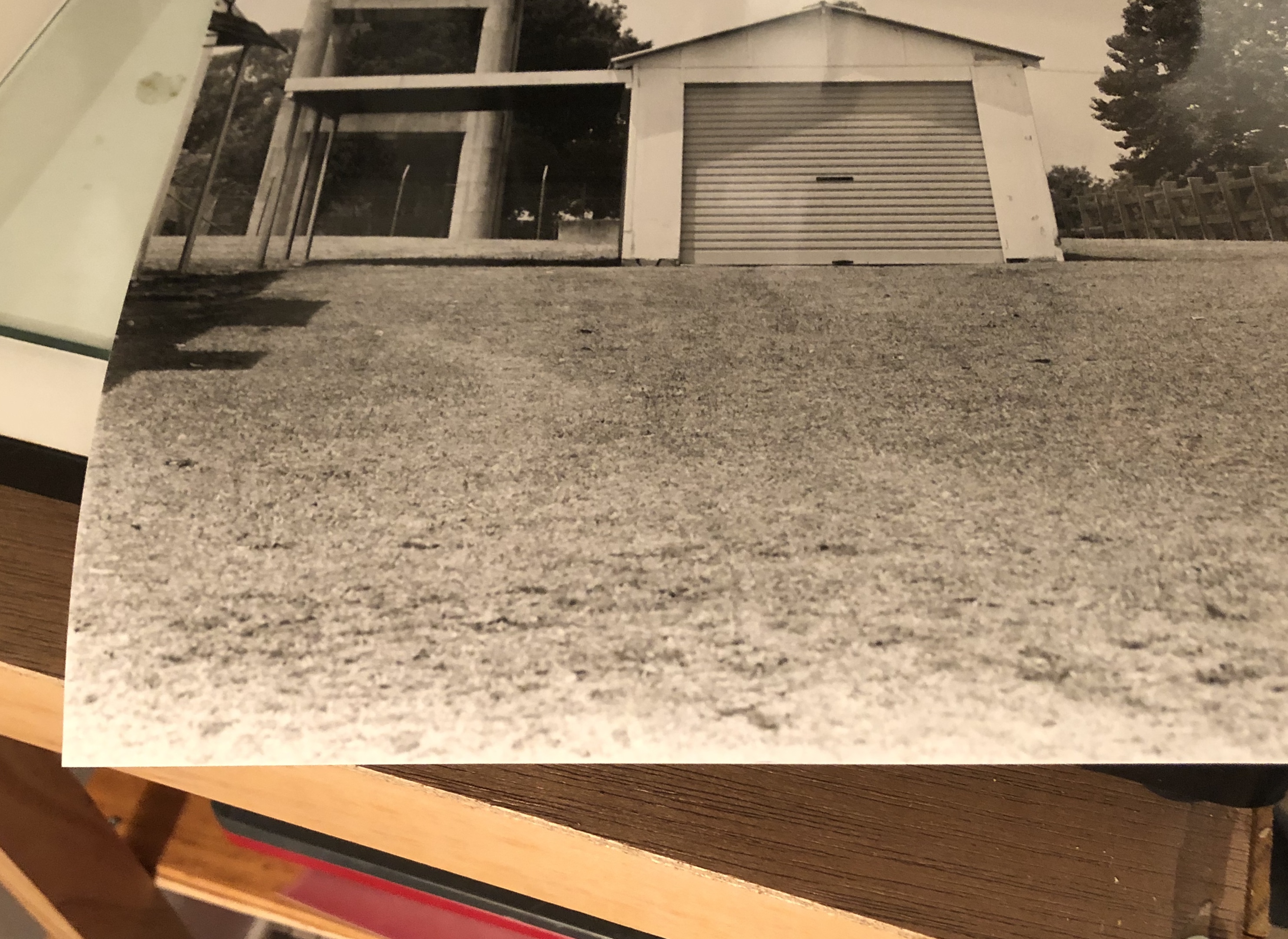

BF70F439-CCA5-4D00-AF80-27700CAE9832.jpeg B158D5CC-62A2-4DD6-96CE-C42642F5E15D.jpeg 64A08327-7237-47F2-AA7C-1288817F3D84.jpeg Hi there. I’ve been enjoying my time in the darkroom lately and have noticed that some, not all, of my prints have a strip across the bottom that seems to be underexposed and gives a kind of reverse vignette across the bottom. I’ll include some examples below.
I can’t really work it out on my own, and was wondering if anyone had ideas about what may be causing it. Cheers

Please share some information on your enlarger setup, lens used, negative carrier etc.
Your images suggest light falloff of some kind towards the affected edge(s), either due to, for example:
* Misalignment of the negative and the lens
* Obstruction of the light path by a protrusion of e.g. a negative carrier, part of the enlarger bellows, etc.
* Insufficient coverage of the lens used (although this would typically result in the problem being worse towards the corners and not just along one or more edges, although your 3rd picture does not exclude this possibility)
