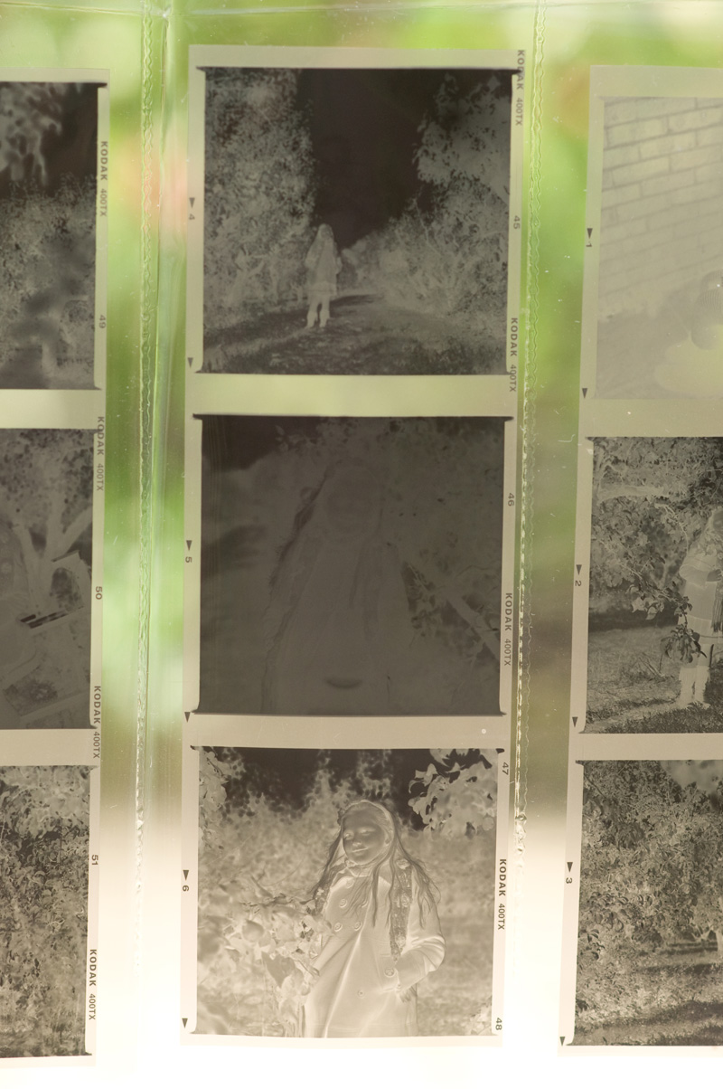

Here are a couple of photos of the negs - unfortunately I couldn't get in close due to only having a long prime lens, so if anyone is able to make any judgements on these I don't know. I tried to keep my exposure correct to be as good a representation of the negs as possible.
Its very interesting to expose for the main light and not the strongest light. I think this thought process will help, especially when thinking too about where my main light is coming from in backlit situations.
I always feel I'm taking a gamble with backlight but I can't resist! I have seen some amazing backlit work and I need a lot of practice to get there!
I would like to take some control over developing and scanning and its something I'm looking into. Starting shooting film is quite overwhelming, but, its the most excited I've felt about photography for a while!
On the photo of the 3 negs, the one at the bottom came out beautiful, it was my favourite photo I have taken of my daughter for a long time and what makes me happy is that I didn't have to take 150-200 images on digital and even when I do, this one for me is better!

In the "close up shot" on the bottom frame it looks like the model's exposure placement is roughly somewhere in the middle so there's probably plenty of detail. Top frame seems to be similar.
IMO, on those two frames, this this looks like a printing issue not an exposure problem.
This brings me back to the thought that you need to talk with your lab and have them reprint it with the face given priority.

negatives 4&6 look fine. 5 I can't really tell. I presume 4 is the one you showed a print on here. The face is a nice shade of gray and should print that way.
You really need either a negative scanner or a darkroom to get consistent quality that exceeds the photolab.
