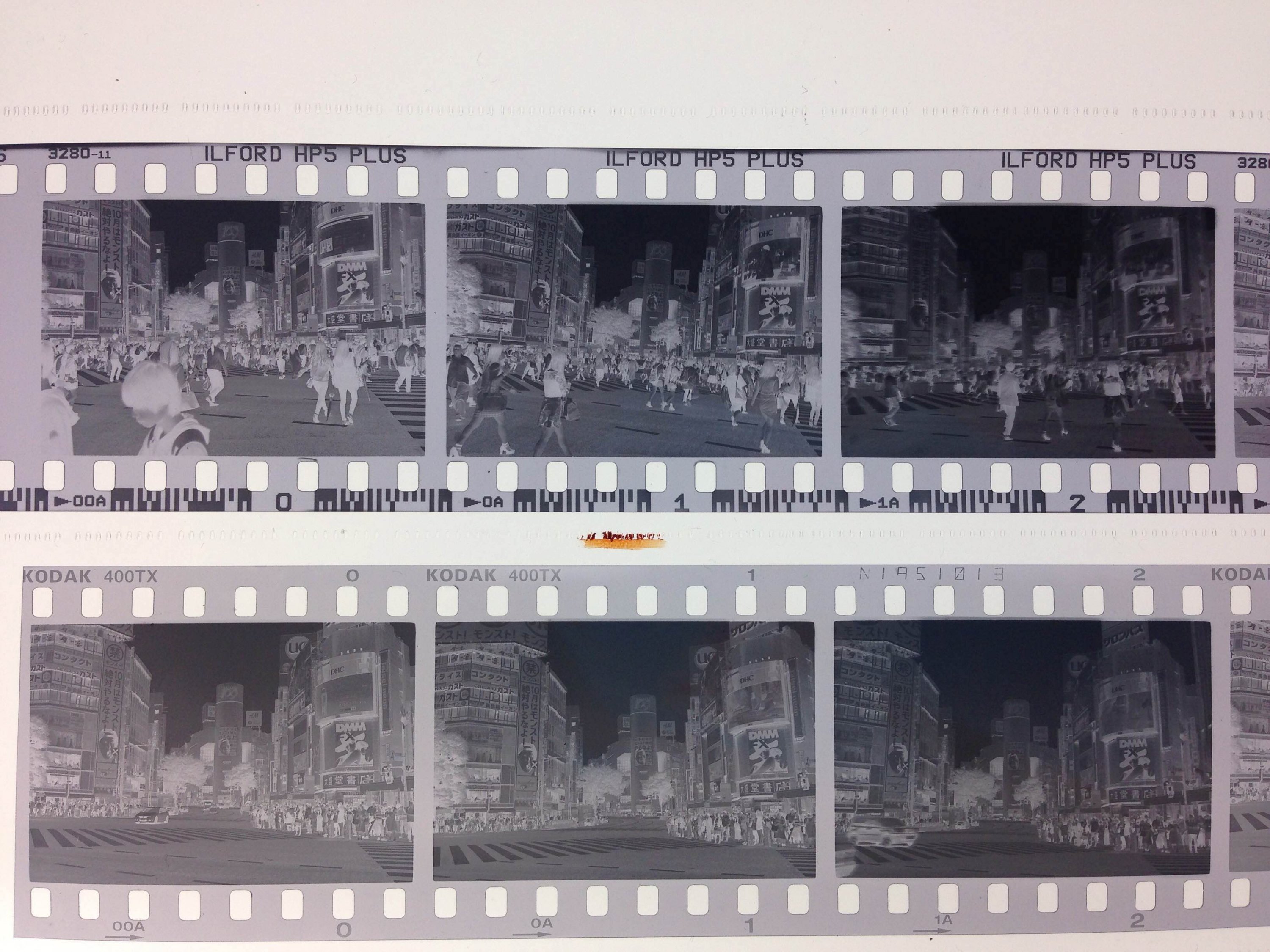

Are the Tri-X negatives below underexposed? They look thin compared to the HP5 above.
The edge markings being so thin makes me think the film was underdeveloped.

Is your tri-x expired? Or maybe your chemical is already out and weak?

The film outside the image area may give you some clues. Comparing them against each other might not be the best course. Comparing them against other negatives may be better. The imprinting on the Ilford if very bold, where the Kodak is a little thin. I've not shot very much Kodak so I don't really not what to expect there, but the Ilford looks a lot like what I've seen on Ilford films. I would lean towards underdeveloped on the Kodak, or maybe more agitation is needed.

Going by the edge numbers, I think the Tri-X was underdeveloped and possibly over exposed.

Underdeveloped Tri-X....judging by the density of the exposure numbers and the film type along the edges.

Tri-X need more development time.

The Tri-X may very well print better/more easily than the HP5, and that is the most important test.
To me, the HP5 looks over-developed. I also note some edge fogging on the HP5, which might be contributing to how dense the edge printing there appears.
Edge printing is, IMHO, at best an inexact reference. Whether it is because of latent image fade (edge printing is exposed at time of manufacture, while your shots are exposed much later) or other factors, I have seen a lot of inconsistency with how edge printing appears in an otherwise properly exposed and developed negative.

OP notice that Matt King and I differ significantly from the less experienced replies.
The exposures on the first and second Tri=X negatives are under-exposed, the correct exposure wiuld be between the 2nd and 3rd, development is about right. The HP5 is significantly over developed as can be seen in the first HP5 neg which is under exposed poor shadow detail but a burnt out sky. I think the HP5 would be awful to print (or scan).

How do the tri-x negatives print? They have less contrast than the HP5 negatives, but may print fine on a condenser enlarger.

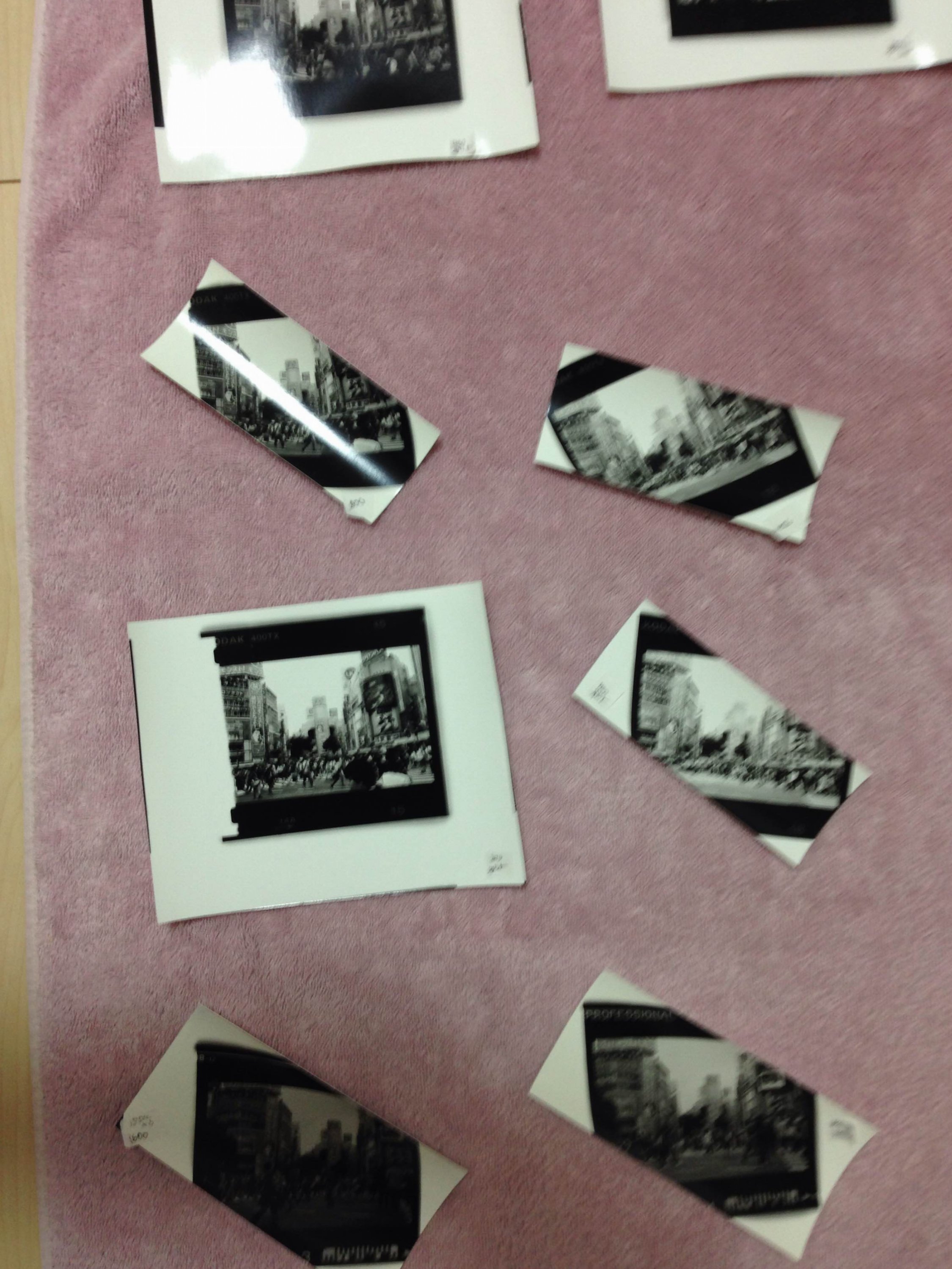

I had trouble getting the tones right when printing both HP5 and Tri-X on Adox MCC110. I usually find min time for max blacks on grade 2 with test strips. Then I print the entire frame with that time. My pictures on both films were always too dark. I know I can use contrast filters or expose for less, but I think that I think that would just squeeze tones of the film.
The above negs were an attempt to see if I need to expose the film differently. I set the meter to 400 and shot, 0, +1, +2, -1, -2.

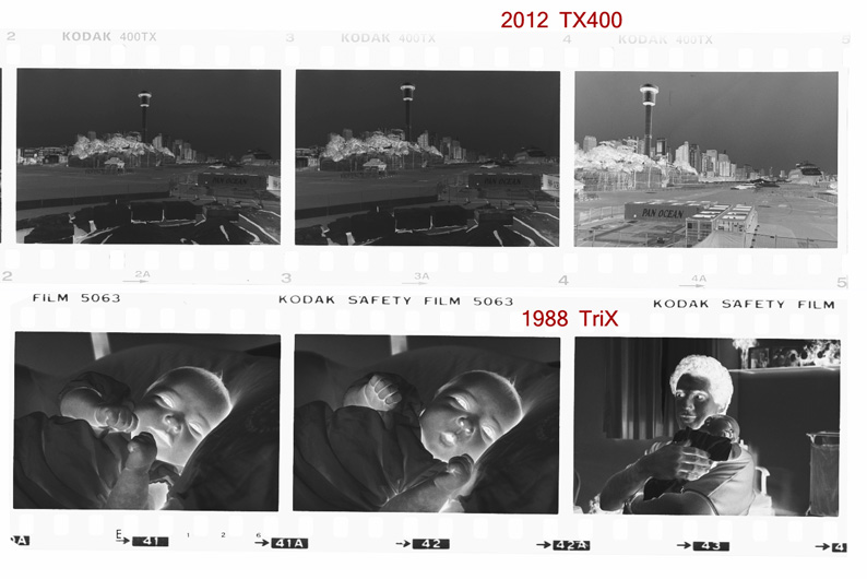

Just had to provide evidence to back myself up. Notice on the 2012 TX400 how the edge markings fade within 3 frames. No doubt there was plenty of exposure and development! I have noticed in particular with TX400 the declining usefulness of edge markings in the last 5-10 years. Also a lesson in how films, technology and quality control etc. change over time. Not buying much TX400 these days and trying to make TMY and Ilford work for me.

In my case it was the developer or developing time.
I developed part of the same roll in Microphen 1:1 and the edge markings look normal.
It seems that 9.75 minutes in D-76 at 400ISO is not enough.
Another thing I noticed since I bracketed the shots, is that Microphen 1:1 gives me about one more stop.
I used the same technique of finding minimum time for maximum blacks at filter 2. Then I exposed all frames using that time.
Tri-X shot at 800 looked and printed the best.
