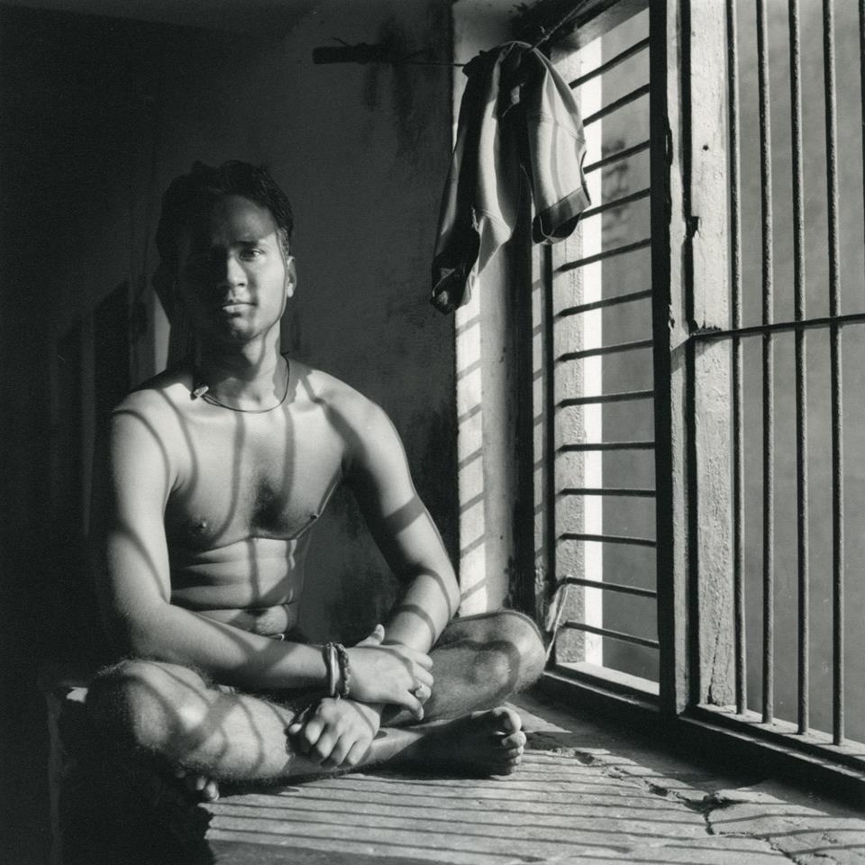

Hello, sorry for a boring topic that's been done to death. I exposed what could have potentially been a very nice shot by 2 stops using Delta 400. A contrasty shot of an Indian bodybuilder by a bright barred gym window. It was at 1/500th instead of 1/125th. My intention was to dev in pyro, which for underexposure I know is a big no no. Gutted about not being able to use pyro because it would've made printing a great deal easier and would've resulted in a far nicer print. I was thinking of pushing it in XTOL or microphen by a little under 2 stops. I'm hesitant about doing so though because I'll have to sacrifice the other 11 shots on the roll and may end up increasing the contrast of an already contrasty scene, rendering it unprintable. Was wondering whether a semi-stand technique could come in with pushing. Any help would be great. Many thanks. Gareth

The other frame was nothing special so it should be all good. I could've had more time with the guy experimenting with different exposures so there wouldn't be a problem now. Some young joker entered and ruined his composure though so he put his vest on and left. I turned up to the place the next day hoping to re-shoot but missed the guy by half an hour. One of the other fellas said he was wondering whether myself and a mate would be their shooting again. I've been seriously sloppy with technique on this trip. I can't bleedin concentrate in India. Too hectic. What dev to use to get the finest grain and most manageable highlights? Are XTOL, Ilford DDX or HC110 good choices?
Here it is in case you ever wondered!

So what did you end up developing it in?
I think it was Xtol in the end or possibly Ilford DD-X. Most likely the first.
Did it come close to what you wanted from the shot?
Yeah, definitely considering the other shots from the previous roll of the same subject juiced in pyro had nowhere near the same amount of detail
