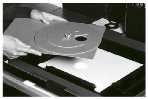

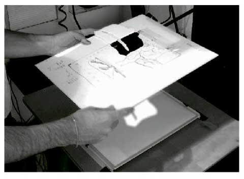

I almost always use a standard or customized burning card to fine-tune the print (see attached). It is helpful to do a dry-run with the red safelight filter in place, aligning the card before committing the actual exposure to paper.

Hummm... ok. But you could do the "dry run" without paper in the easel or with a scrap sheet turned back side up for focussing. That's what I do.
Not that it matters - of course do what works for you. I was just curious if I was missing something and should get the filter and holder for my enlarger. :smile:
As you said, there is more than one way. To me, it's more convenient to expose right after trying out the right 'position' for the dodge or burn. When I have to get the paper after the trial run,I seem to 'forget' the exact position for small-area burns and mess it up a bit.
Another way to do it.....
I usually have two "tools" in my hand. "Dodge/burn" tool will be held my left hand in approximate position on top and a blank sheet will be held my right hand covering the entire area of paper under the tool. I set my timer to "metronome" position and set it few seconds longer. The extra second will be used to align the tool with paper covered. Then, at the right timing, I remove the card on right hand.
More complex to explain than do it.... it works for me.
