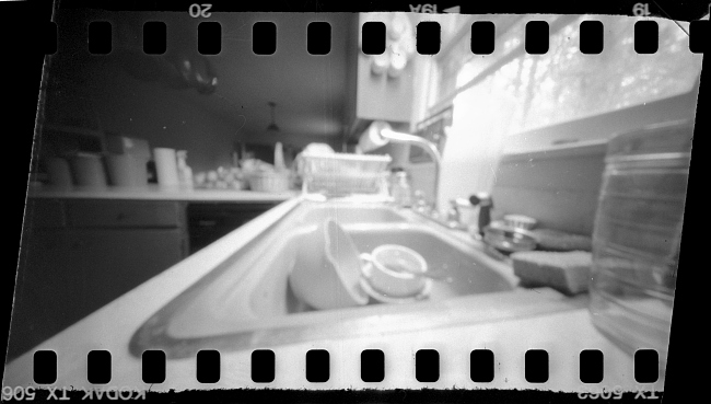

Don't bother with a center grad. I've got a couple pinhole cameras made from Altoids gum tins; they use a 60 mm strip of 35 mm film, with a 16 mm projection distance. That's about 115 degrees corner to corner, and though the light falloff is visible, it's not really objectionable as long as I use film with good latitude and a development process that doesn't accentuate the contrast. Tri-X fills one half of that; HC-110 at high dilution with greatly reduced agitation (every 3rd minute) gives the other half. See attached...
How high of a dillution and for how long, Donald?
Thanks
My times are quite a bit shorter than many, so fair warning...
I use Dilution E (1:79) for full length 35 mm and 2x120 in my Paterson; Dilution G (1:119) for 120 on stainless and sheet film in my daylight fill tubes. For Dilution G, I give Tri-X 21 minutes at 68 F (20 C) with continuous agitation the first minute, then agitation every third minute; Dilution E, at 2/3 the dilution, gets 2/3 the time with the same agitation, or 14 minutes.
This development pushes up the shadows while keeping the highlights in check, which can produce a flat negative if the light is flat -- but it's a lot easier to add contrast (within reason) in printing or scanning and still get a good result than it is to remove it...
