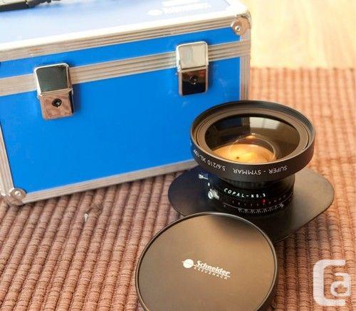

What "modern" lenses would you choose if money was no object for use on 8x10 with "plenty" of room for movements, sharp center-to-corner and as "relatively" small/lightweight as is practicable given the other criteria?
Focal lengths from approximately .33x to 2x.
My choices:
110 SSXL
150 SSXL
210 SSXL or (210 Apo Sir.-W) or (210 Computar or early Graphic-Kowa)
300 Apo Sironar-W (or 305 Computar or Graphic-Kowa)
450 Fuji-C
600 Fuji-C

I guess it depends on where you go or what you want to do. I just don't see myself carrying around a 210 Super Symmar in its own suitcase. Like which extra hand am I going to use to carry that and the monorail 8x10 to go with it? :smile: :smile:
