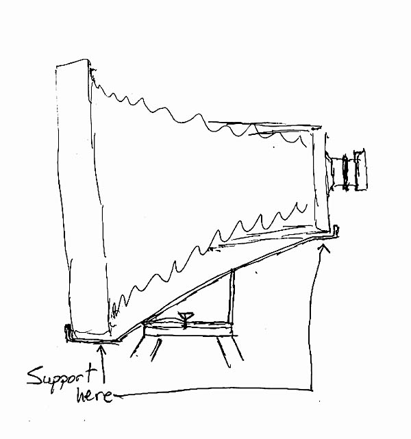

After giving this some further thought, the problem could be solved quite easily with the following accessory.
I have a Ries A250 head. Bolt a lightweight square base the same size of the Ries head into the base of the camera that uses both receiving holes. Recess these screw holes so the base will fit flat on the top of the tripod head. On one side of the base camera plate put a ridge lip that will acept the side of the A250 head and act as a further deterent for rotation. On the bottom of this camera plate will be a 3/8" receiving screw so this can be attached to the A250 tripod head. The ridge lip should be utilized on the on the top side of the head to provide weight support of the attachment screws and prevent rotation of the camera.
I've thought about this problem some. So far I've limited my verticals to 7X17 because the Folmer 717 is simply tough enough and small enough to handle the strains well. I use an old Davis and Sanford tripod for doing these that has the most generous table of any of my tripods. It also tilts past 90 degrees which helps in weight distribution some. But since I will likely be using the older ricketier Korona's and Folmers for the rest of my life I've been thinking of building a dedicated table for verticals. 3/16" aluminum plate would be plenty strong enough. It would support the camera in a couple of vulnerable points and the cameras tripod thread would only need to 'locate' the camera to the table. Here's a very rough 2D sketch.
Jim, I like this idea. Would the design limit the bellows draw? Or does it slide somehow.
Stay Focused....or Soft Focused!!
Jim
The design as sketched would limit the bellows somewhat. For 8X20 I would design it around my 19" focused at closer than infinity. The 1220 and 820 would use a common table. Maybe you could design in a 'step' for 14" lenses to land on. A 14" and 19" would give me 99% of anything I would ever use. YMMV
