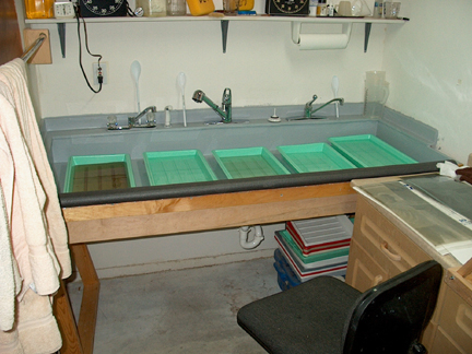

Dan Dozer
Dec 10, 2004
411
My darkroom sink ready to go for developing 8 x 20 negs with trays from Park Seed Company. Side counter is about 10' long with enlarger at opposite end for printing.

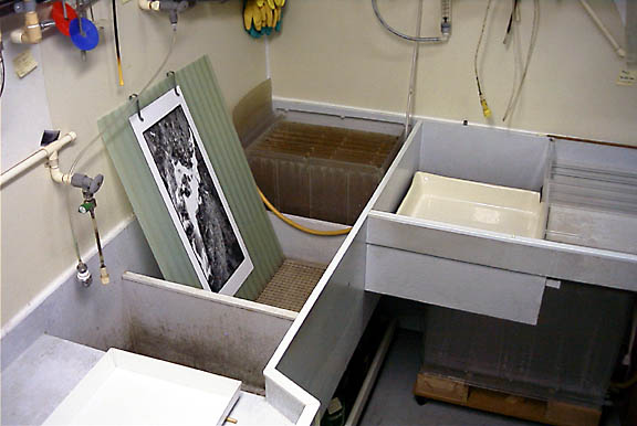

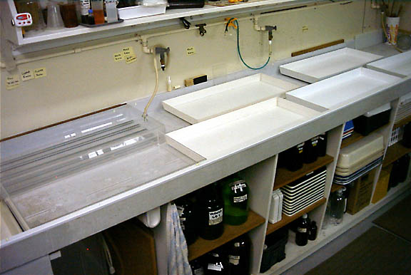

Reinhold
Advertiser
Aug 20, 2003
911
Washougal, Washington
A few more ideas...
The corner drain in my basement forced me to adopt a right-to-left workflow; awkward at first, but I got used to it.
I'm 5'8" tall, my belt buckle/elbows are at 40", so my counter sills are 38" high. (39" would've been ok, 37" would've been too low).
My large wet counter is 26" wide x 120" long x 3-1/4" deep, and slopes 3/16" per foot toward a 26 x18 x9" deep sink. On this counter I place 5 home made styrene trays that are 11.5 x 26 x 2" deep, (with a 3/8" wood stick under the low end to keep the fluid depth level). These larger trays let me print 8x20 contacts with very generous borders.
The trays are oriented left/right, rather than front/back, (much easier to handle large prints).
There's also a 12.5 x 25 x 2.5" deep acrylic tray for a pre-toner conditioning bath of 2% sodium sulfite.
And... a 12.5 x 27 x 3" acrylic wash/hold tray with slow running water. It's overflow fills a tray which is used as a back-up holding tray when things get busy
The toning is usually done on...
The smaller 22 x 66" wet counter. It slopes 3/16" per foot toward 3 sinks that are 12" deep.
I mix chemistry in the first deep sink, wash RC papers in the middle sink on a fiberglass "Washboard" with a hose-end spray head. There's a 16-slot washer that can handle 32 11x14" fiber prints in the far sink.
If I'm printing on RC papers, the final wash is a 3 minute shower on the Washboard. (Remember, they've been in the "hold" tray for some time by now, so 3 minutes is adequate).
If I'm printing on fiber papers, I clean off a counter and re-arrange it with successive trays of water.
I could also use a home made 10 slot acrylic washer (12 x 27 x 10" wide). Not shown.
Silver printing.
A general overview of the entire darkroom is here...
http://www.classicbwphoto.com/Darkroom.html
Reinhold
www.classicBWphoto.com
