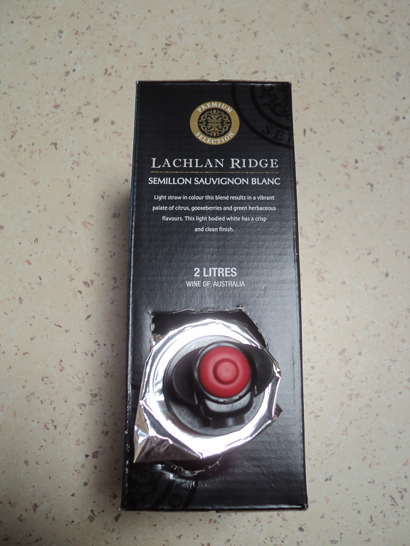

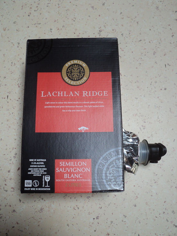

Not sure if these are available outside Australia, but I use old wine casks for my darkroom chemistry.
These have the advantage of tap dispensing - as well as collapsing as the chemistry is used, without allowing air into the chemical container.
Of course one has to drink the contents first :smile:

That looks like it has the mylar type bag in it - which is good, as they are quite impermeable to oxygen.
Around here they have mostly switched to a clear plastic that isn't particularly oxygen impermeable.
Toyo
Aug 2, 2015
233
Mid North Coast NSW - Oz
All the Australian cask wines that I have seen (drunk) - have the mylar type bags inside. These have the added bonus of also being light tight for any chemistry that might be light sensitive - (if there are such :smile: ) The biggest plus is the oxygen barrier of course, and after the wine has gone the casks are free - yay!
