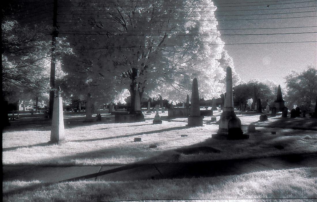

I developed my kodak HIE in D-76 (stock) for 9 1/2 mins.Tyrned out ok.
Mike
Mike
That's what I normally use (ID-11 which I hear is pretty much the same formula as D76).
BTW, that's a really nice image. What kind of EI do you use? I usually go ISO 25 with a dark red filter (#25 or #29) for HIE, though it tends to come out a bit on the overexposed side a lot of the time.

Hi Walter 23. I set my iso to 50 and mounted an 89b gel filter between the film rails of my Nikon FE.Much easier to compose a shot as the 89b is so black that metering/viewing through it is near impossible.
Mike

Ahh, I've never tried this film with a really opaque IR filter - just the dark red #29 or red #25.
Will have to give that a try!
