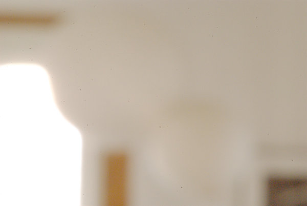

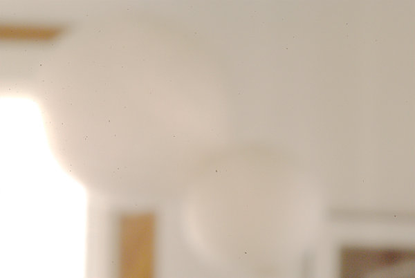

Anyway, here are a couple of shots I took using a digital SLR - which means the FOV is even narrower, comparable to a 320mm for a film camera. As you can see, the results are pretty unusable. Pinhole sizes are 1.2mm and 1.8mm (the one I would like to use for exposure purposes).

A 1.2mm hole means you're going to have a resolution no better than 20x30. It's going to be a spectacularly blurry mush.
"Spectacular" is the right word...
