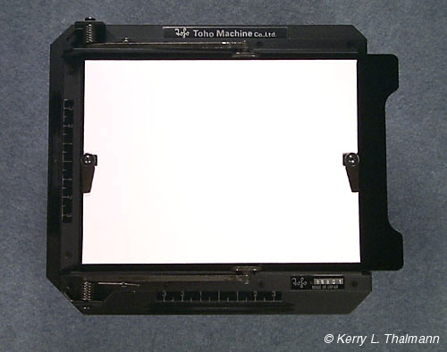

I don't know what to call the kind of back my 4x5 camera has but its a spring loaded hinged arrangement to slide in the film holder. I believe this is common. The camera is a Toho camera the same model as this image of the back from KerryThalmanns site.
I'm interested in using a roll film back with the camera and because most of these are made for operation with a grafloc back. Now my camera does not have that so I'm down to sliding it under the flap (can someone help me out here and tell me what this sort of arrangement is called please?)

Your back is generically called simply a "spring back," and what you want is variously called a "Graflok back" or "International back."
Calumet, Sinar, Linhof (Rapid Rollex), and perhaps others all make backs designed to slip under the groundglass, if you would rather not have to make a Graflok-type back for your Toho.

I read your first post; what you look for is easily made. I have made/adapted backs for my cameras many times, and it is not rocket science to make one to work well. I am attaching a scan of my Graflex 6x7 rollfilm back with a slot that I cut in the edge (does not change the dimensions) so that it would key into my Wista 45SP's back. All you want is a way to "grab" the edges tight to the camera. My Wista had sliding steel retainers, while my Chamonix has rotating retainers. You can use porch door sliding bolts or any other similar hardware to achieve this.

actually the part I was wanting to take a look at the way that the 'back looks' on the camera with the grafloc film / glass removed. Sort of like the same angle I had in the image I put in my first post Just so I can see what it looks like. Like how the mechanism torques down and allows release
but from your description I think I can just adapt something using the hinge glass I have and the grafloc roll back I'll get as a guide on how it should work.
