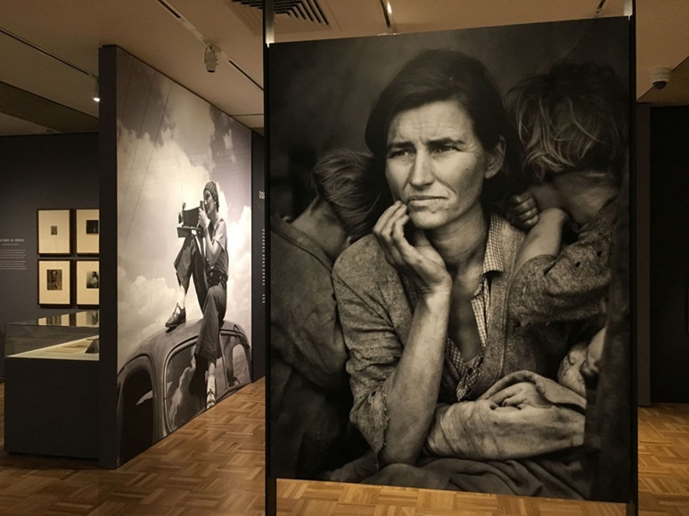

As I went looking through what information I could find, I came upon a link to an exhibit where we can see a different emphasis on the central subject, which I speculate must have been a curator's decision or interpretation. Perhaps the curator's vision of how the image would best fit the space and exhibit.

When you add different media, formats and presentations into the equation you complicate your task by orders of magnitude. The image from the Library of Congress website might be a contact print from the negative intended solely for cataloguing purposes (or it might be an actual print). The print from the exhibition could have been produced on a different media (inkjet/canvas?) unavailable at the time the photograph was taken.
