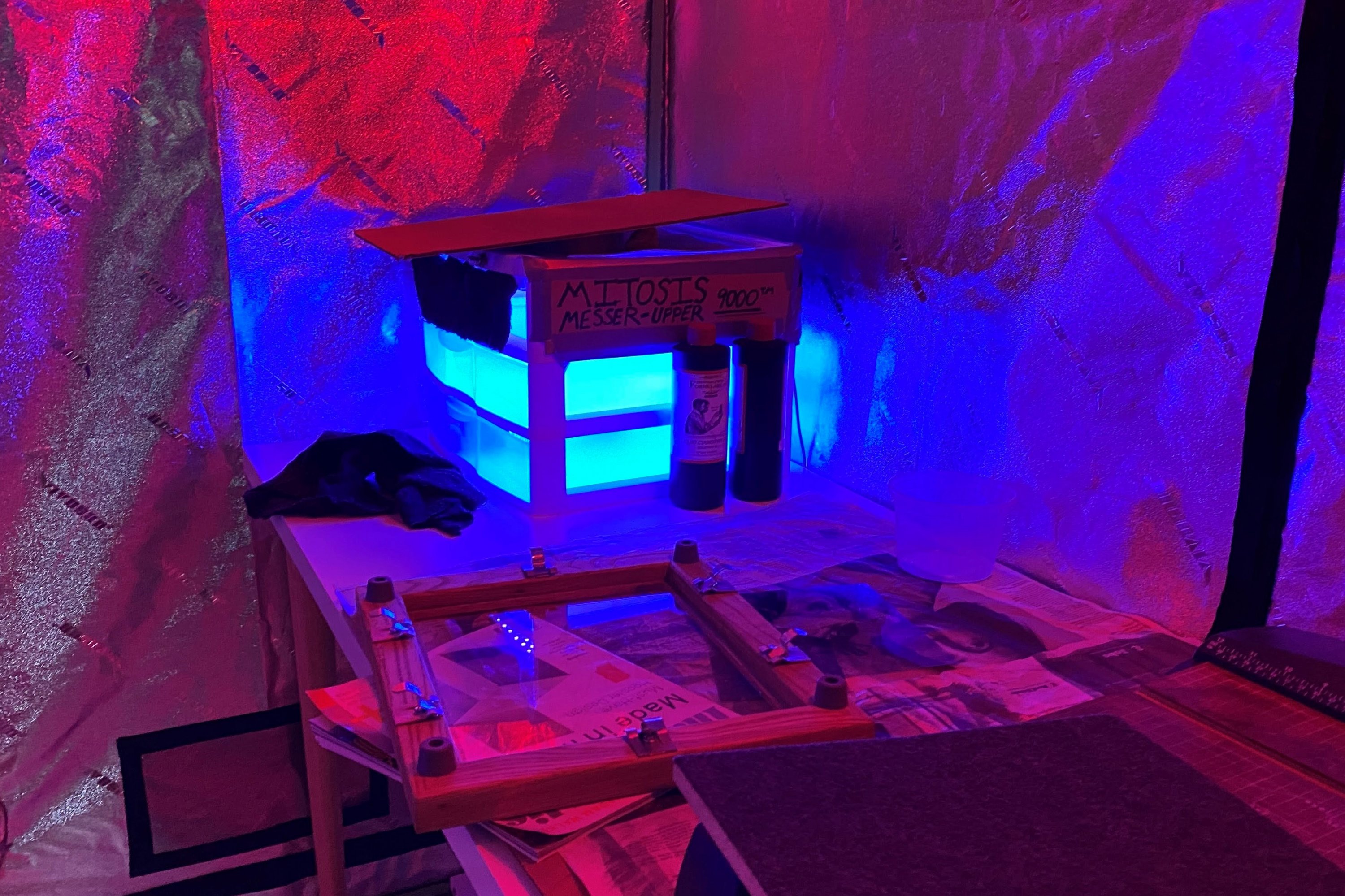

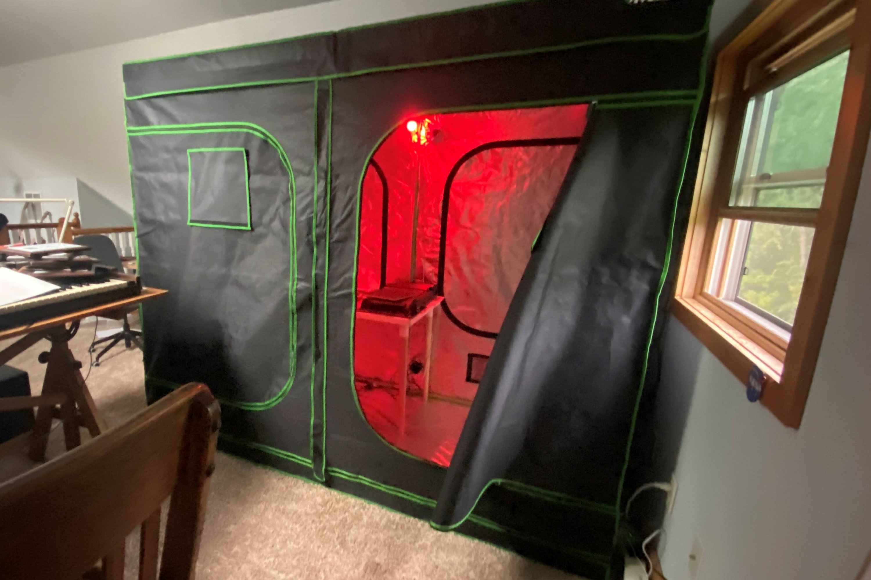

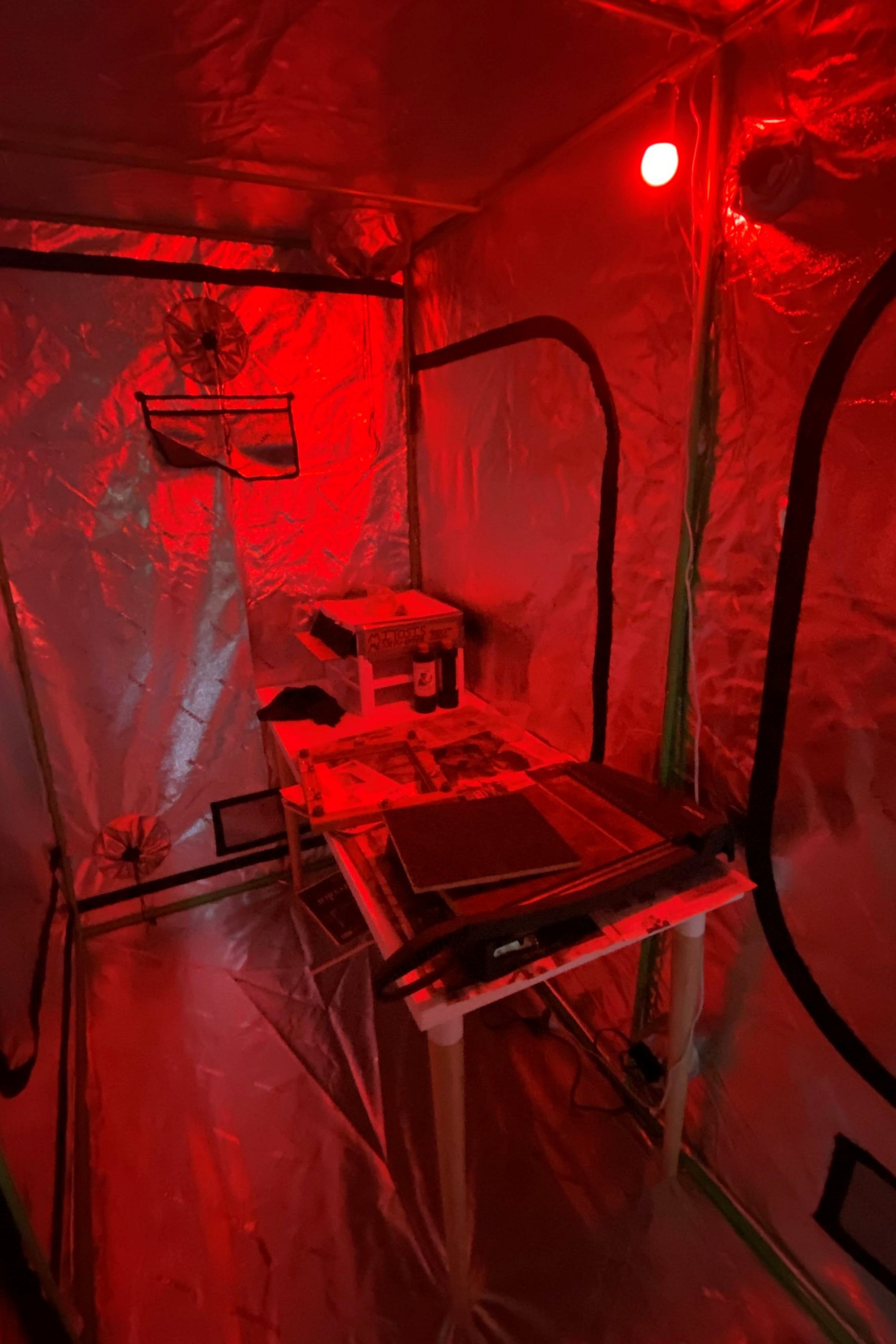

As I've started branching out into multiple film formats and processes, the basement bathroom has been growing increasingly limiting. For a while I considered blocking out a bedroom to convert into my new darkroom. However, I recently came across this grow tent on Amazon and decided to give it a shot. The tent is completely light-proof, waterproof, and features multiple vents. I couldn't be happier with it!

Nice! Obviously not plumbing and wiring friendly (though if it's for growing "plants" it might well have wiring pass-throughs) but also looks semi-portable. Wet plate photographers take note...

That looks like a great tent you bought. Well made, and properly designed. A couple of cans of flat black spray paint might tame down those reflective walls. Good for plants, not so good for a darkroom.

I don’t understand why the reflections would be a problem. Reflecting red light cannot be harmful, it’s not amplifying anything but only reflecting it.
In other words, if the main source is 4 feet away from the paper, and of sufficient wattage, any reflection of that light source cannot be harmful.
Also, printing while the red light is on will not be harmful.
Don_ih
Jan 24, 2021
7,374
Ontario
The only reason to be concerned is the excess light from the enlarger. All my enlargers emit a bit of white light through their vents and/or around the negative holder. Reflecting that light could fog the paper a bit.

Painting or covering walls near the enlarger black is considered standard.

I have a grow tent just like this, only smaller, and use it as a darkroom, I have had no fogging due to the silver reflective walls, it's not a problem.
