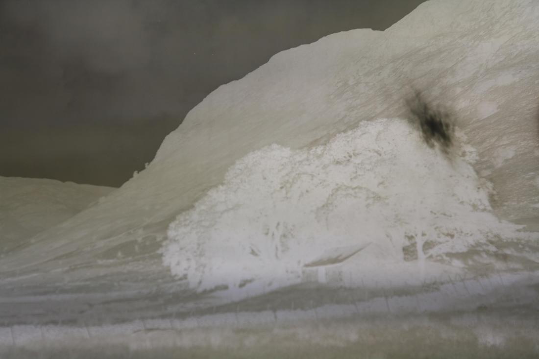

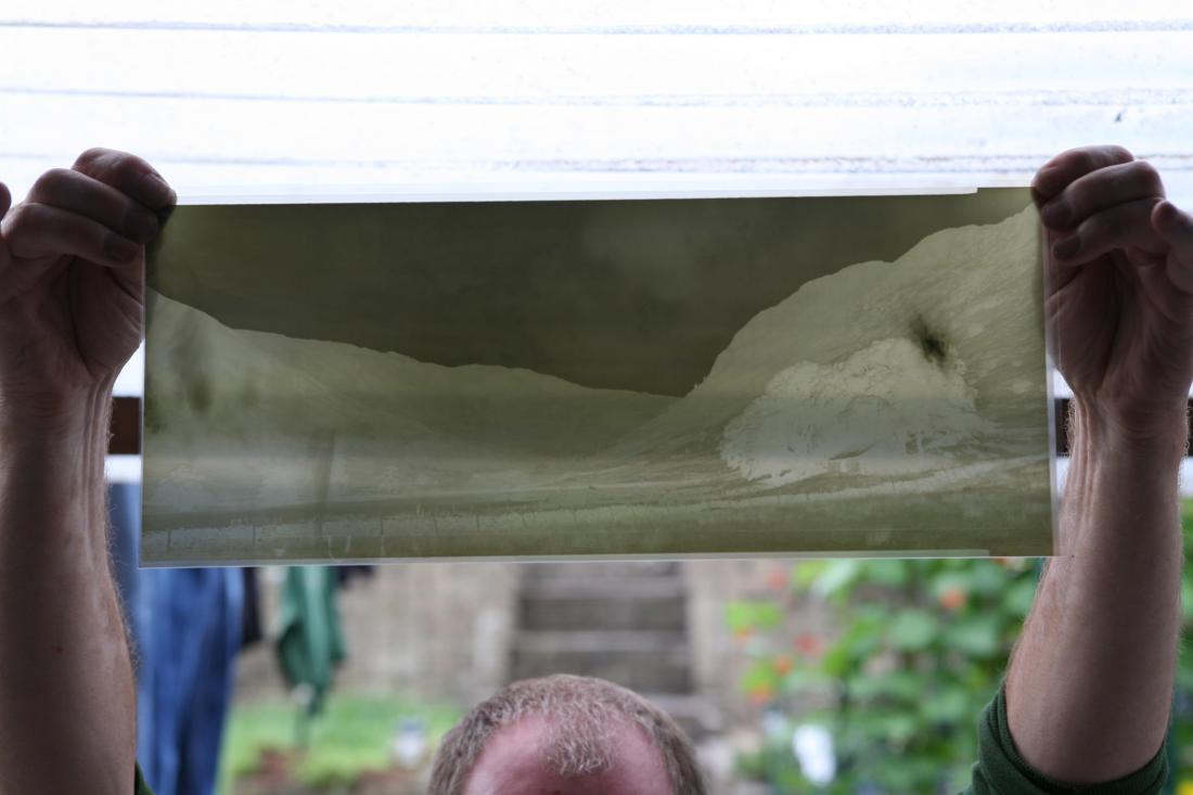

While we're on the subject of these lenses! I've had a few odd marks on my negs which I couldn't attribute to anything other than a light-leak or flare and I'm pretty certain the bellows are in good condition, seeing as in more subdued lighting conditions haven't caused any problems. Then again, one shot I pointed directly at the sun peering through clouds came out fine. This was taken with a turner reich triple convertible 12-21-28 Underexposed too, which is fault of my own
