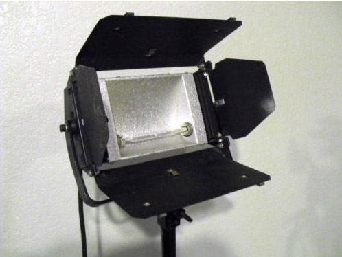

Most certainly, it's a killer product... but when possible, I'd rather just move a barn door a half inch than start wrapping lights! And the price for a roll of that would likely buy you a decent hot light with barndoors and an in-line switch. Just not a work light fan when there are less frustrating options available - though I do like the fixtures that take the worklight style double ended globes - the 100 - 300 watt versions are just a couple bucks, 500/650/750's not much more.
Vs. a work light, I'd much rather pay the same $$ for one of these... to each their own of course...

Mountains of stuff on the bay today - and man!!! So many retro-cool fresnels - I want one with, like a 100 watt on a dimmer for a reading light by my bed - groovy groovy groovy!!!
With full awareness of this stuff being so subjective/personal, I'll throw in that for 15 years, the rectangular open face lights have been my bar-none favorites for bounce and diffusion... you can perfectly fill a diffusion panel with 'em, make tiny slots of light, and 4 of them will fit in a dairy crate since they close up so small... if you're patient you can find them for under $50. Colortran also makes a model that uses a shorter globe... having 4 or 5 of these, you can light a room or set very naturally.
