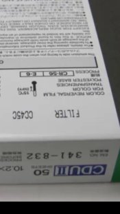

CDU II is an E6 film and is for making internegs isn't it?

Thanks,
Nope.
If my internet searches respecting what CDU II is are correct, that is a dupli\cating film.
You use it to make duplicate transparencies.

Nope.
It is a slide duplicating film...
Looks like E-6 to me

Oh!!!!!!! Ugh......
Slide duplication makes a copy not interneg... Wow I'm slow...
