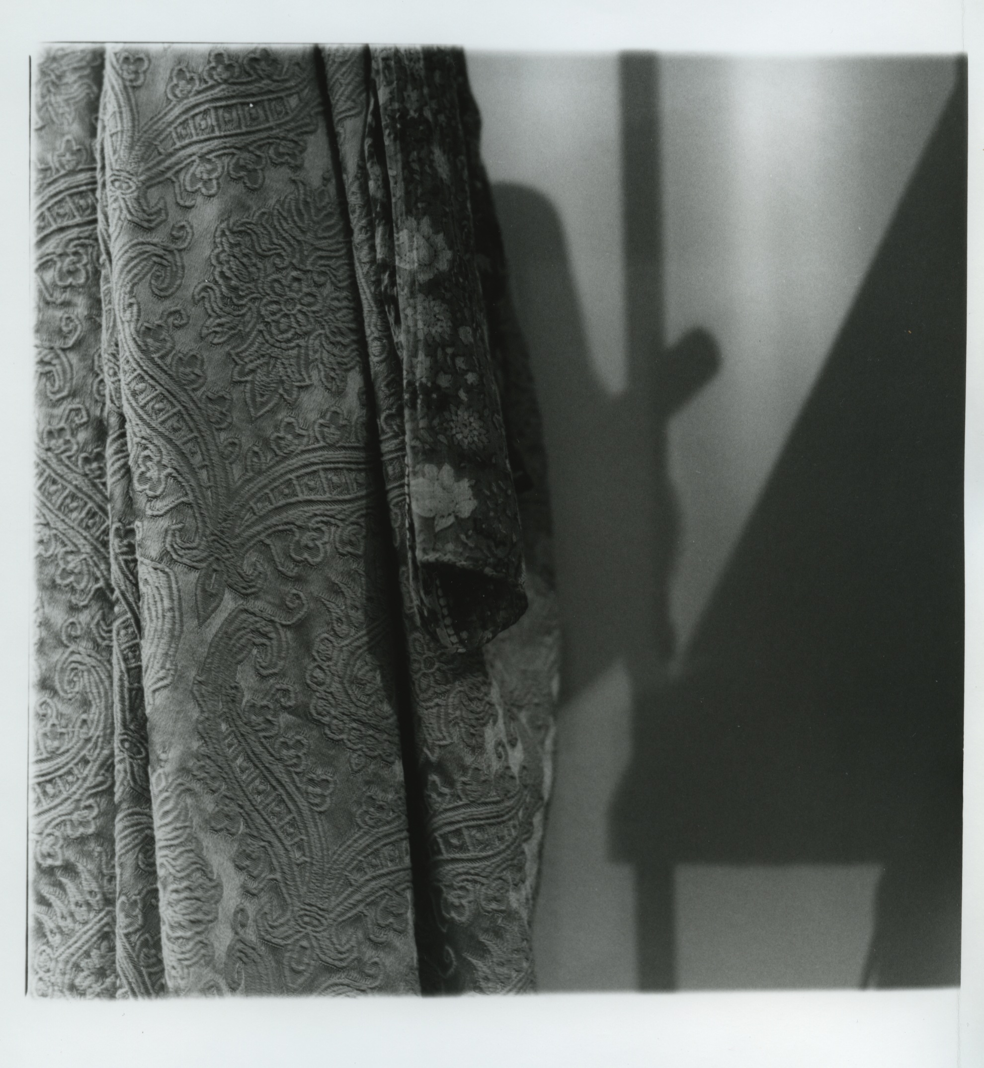

I made a print of a scan.
I love the "silvery" tone of the scan, the gray scale, and I am finding my print a bit harsh. Is that because it´s too much time?
Can someone recommend what paper or how I could emulate it or is it impossible, as they are distant processes?
It´s Foma 200 in Rodinal taken on Hasselblad.
I use Ilford Multigrade,
Grade 2 filter
Slavich Bromportrait 80
Perhaps I should try less time and first on a normal RC paper and as I suspect the Slavich one is a bit warm.
Also maybe i should try a softer grade.
But advice to a novice printer is appreciated.
attachment.php
The image with a bit of white background is the silver gelatin print.

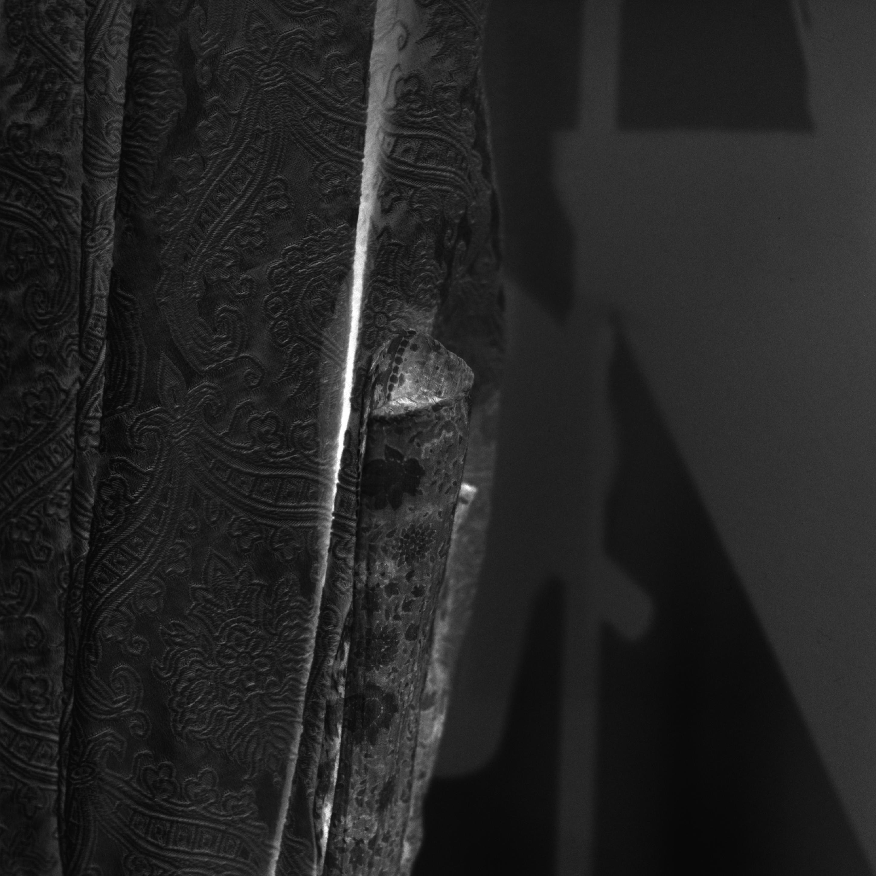

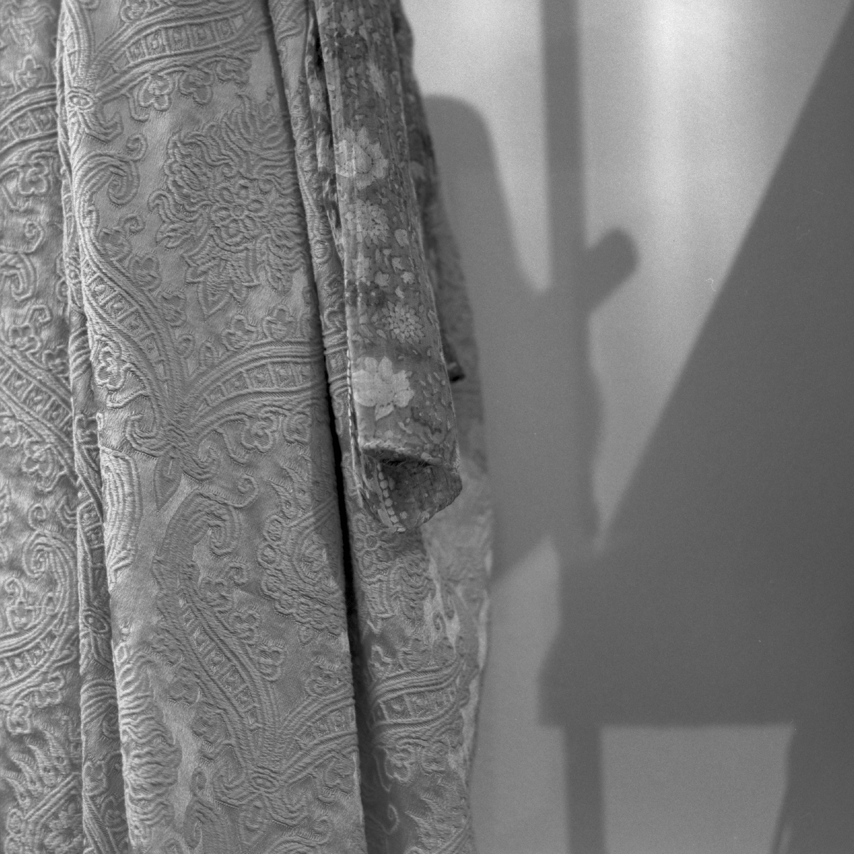

attachment.php
attachment.php
attachment.php

There are lots of reasons that trying to match a silver gelatin print to what you see on a monitor could be very difficult, and perhaps impossible.
For starters, try reducing the exposure by 1/2 to 1 stop, and then try some contrast adjustments, perhaps 1 1/2 instead of 2.
To my eye and monitor, the scan looks a little warmer than the print, it will be tricky to find a paper and developer combination that could get it just right. Some Ilford MG might be a good start though.
