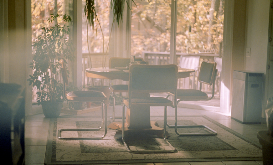

Greetings!
I've been having a problem with what seems to be a mysterious light leak on my Leica M6. It appears as a large oval shaped section of low contrast in the center of the frame.
It does not seem to happen only in situations with harsh light where i would think a light leak would be worse, and it doesn't happen very often so it's a bit hard for me to diagnose.
It has happened with several different lenses too. I was wondering if it could be a development issue? I thought it might be a problem with the way I was scanning them on my Epson v700, but it appears to be on the negative.
Thanks for any help!
Casey

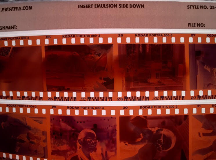

Here is a shot of that negative plus the few after it that have a similar issue. These are being processed at a local lab in a minilab machine.

The "fog" extends outside the negative frames, between the exposures. That would indicate to me that it's not light coming from the front of the camera. So it's either a light leak from the back of the camera (seems unlikely to me as the light would need to pass through the film to reach the emulsion side) or (more likely to me) a processing issue, like incomplete bleaching or fixing. See what happens when you bleach and fix the film once again.

I don't think it's a processing issue because each frame has a distinct pattern. A processing problem would extend uniformly across the frames.
