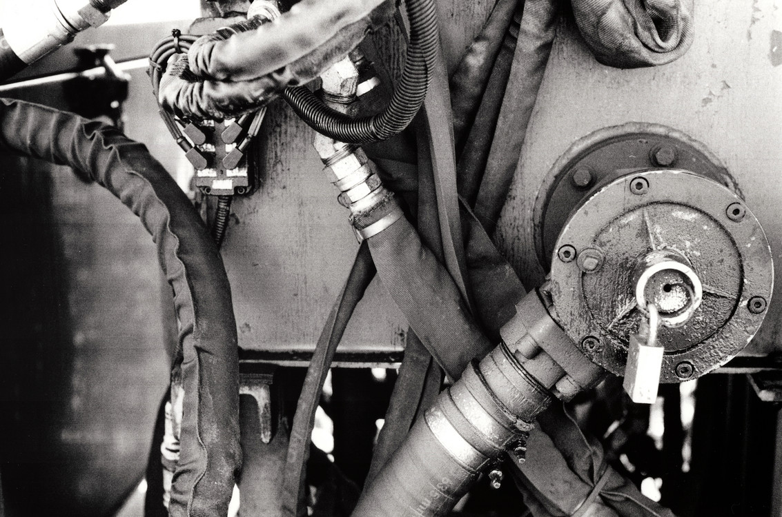

For example, here is Foma 200 35mm semistand processed for an hour - Note the mid tone contrast of a scene shot in very flat light. Scan of silver print:
(Leica M2, 50mm f/2 Collapsible Summicron handheld. Pyrocat-HD 1.5:1:250, 2 min initial agitation, 10sec agitation at 31 min. 60 min. total time. Developed in a Nikor stainless reel and tank with the reel suspended off the bottom of the tank with an inverted funnel.)

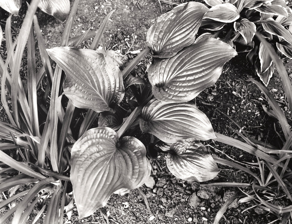

Here's a scene I did a few years ago taken in absolutely flat light late in the afternoon that shows some of these effects. I do not recall whether it was done with semistand or EMA, but I am very sure I would have not gotten this look with normal development. Whether you like the look or not is another matter:
