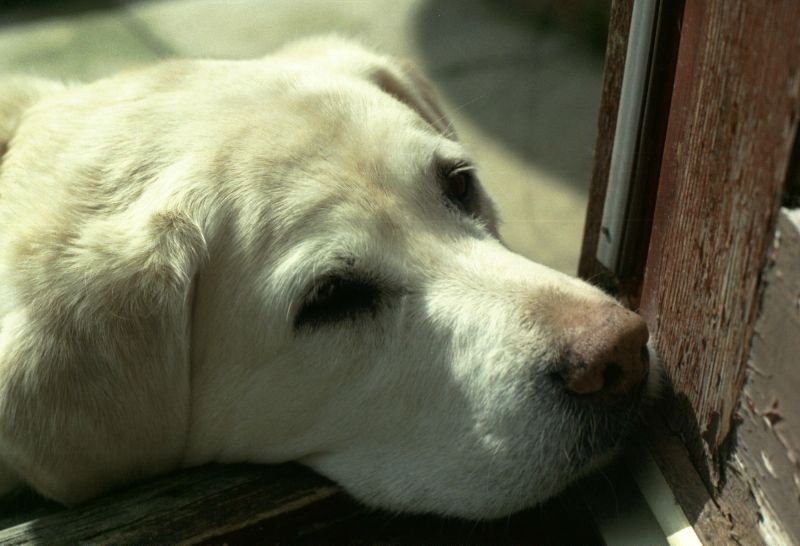

Normally I develop (though not print) my cheap C-41 "snapshot" film at Asda here in the UK. The Fuji Frontier there doesn't seem to scratch negs and the usual guy at the desk seems capable of handling them with a reasonable degree of attentiveness and sympathy.
I've had some rolls of Kodak Gold 200 I hadn't got round to processing, I had picked up one of their (Truprint's) processing envelopes and me being inquisitive and them being cheap sent them off, and asked them to be scanned to CD too, hardly expecting pro results, of course...
I won't bore you with the details but this is one of the few frames that doesn't have two or three long scratches running down it.

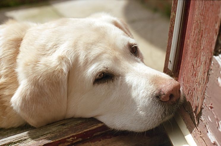

Also attached is my quick attempt at scanning the same frame.

I think the secret is to find one lab and stick with them, I have a guy who knows me well, cuts my negs into 6's and they never scratch my negs (35 or 120).
The colour is off, but if you send that neg to 20 different labs you'll get 20 slightly different results.
Find a decent lab and give them your money.

Trueprint have always been awful, I don't think they know what quality control is.
Most pro-labs now use digital minilab equipment for all their 35mm & 120 films. It's really only the skill of the operator and their judgement of when to over-ride the computer, and also the correct replenishment of the chemistry- and even this is automated on most machines.

I had figured in the 21st century with todays modern processing equipment they could at least turn out a passable set of prints from one of the most common negative films on the market today. Seems they haven't bothered to calibrate and profile their equipment at all.
I posted this as a warning to others who might consider cheaping out and sacrificing their film to them. The prints have to be seen to be believed. They really do look like shots taken on my grandmother's 110 pocket Instamatic in the 70's - after they've sat in the drawer for the last thirty years and shifted colour.
But the main insult to me is the scratched negatives, where the damage is permanent and irreparable. Presumably they don't bother to perform basic maintenance on their equipment either. Fortunately for me, my snapshots weren't terribly important, but I wonder how many ordinary consumers have had their once-in-a-lifetime memories trashed in this manner?
This type of shoddy processing damages the reputation of film in the consumer consciousness. Could it be a ruthless ploy to push everyone onto digital? Thinking about it, the inside of the film sleeve asks ominously, "Thinking of going digital?"
I'm feeling paranoid now...

Conspiracy? No, dont worry, this kind of colour was being produced in the 1970s as you have said, when anything involving the word digital meant using fingers! The expression " old sea-dog" springs to mind but in this print the old sea-dog hasn't found his sea legs yet, judging by the greenery around the gills!
I have only seen my local mini-lab( owner operated)) in operation and in that one the operator watches each "print " for colour and can alter before printing and does a great job as it needs to. Poor prints = poor reputation which spreads and in a small town = out of business.
In chain store operations these constraints don't apply, made worse by the prime directive of profit via high throughput and low cost which translates into poor training and low wages. Pay peanuts and you get monkeys - usually ones who turnover rapidly.
Shouldn't the top management see the sense in preventing this happening? Not if they are governed by the new but key management maxim: Short termism rules OK. There's an upside of course. If companies were properly run there would be no "Watchdog" and the Glitchfinder General, Mr Campbell, ( the Scots are everywhere) would be out of a job and we'd be short of the entertainment of a metaphorical " burning".
FWIW, I've seen a lot of complaints about scratched negatives on the Web, usually associated with 1-hour labs. My impression is that the roller transport mechanisms these machines use can scratch negatives if they get too dirty, which is an all-too-common occurrence. Of course, this doesn't excuse any lab for producing such results.
As for practical advice, if the scratch is on the base (non-emulsion) side, it can be hidden. I've got a bottle of something called Hide-a-Scratch or No-Scratch or some such thing in my darkroom. It's a brush-on fluid that does a remarkable job of hiding scratches. Rubbing bodily oils (like from your nose) over the scratch can do the job, too, but my own nose oil seems a bit gritty, and the one time I tried it I got specks on the print, so I'm sticking with the commercial product. Of course, treating your negatives this way is a nuisance, but at least it's possible to correct at least some types of scratches if you do your own printing. (I'm guessing the same techniques work for scanning, but I've not tried it.)

If you see how negatives are sometimes handled at 1 hr labs you'll realise most damage is done by poor operators, not the machines themselves.
The negatives are processed on one machine and scanned by another, in between the negatives are hung up, waiting. The operator has to handle the film, this is the major source of problems.
