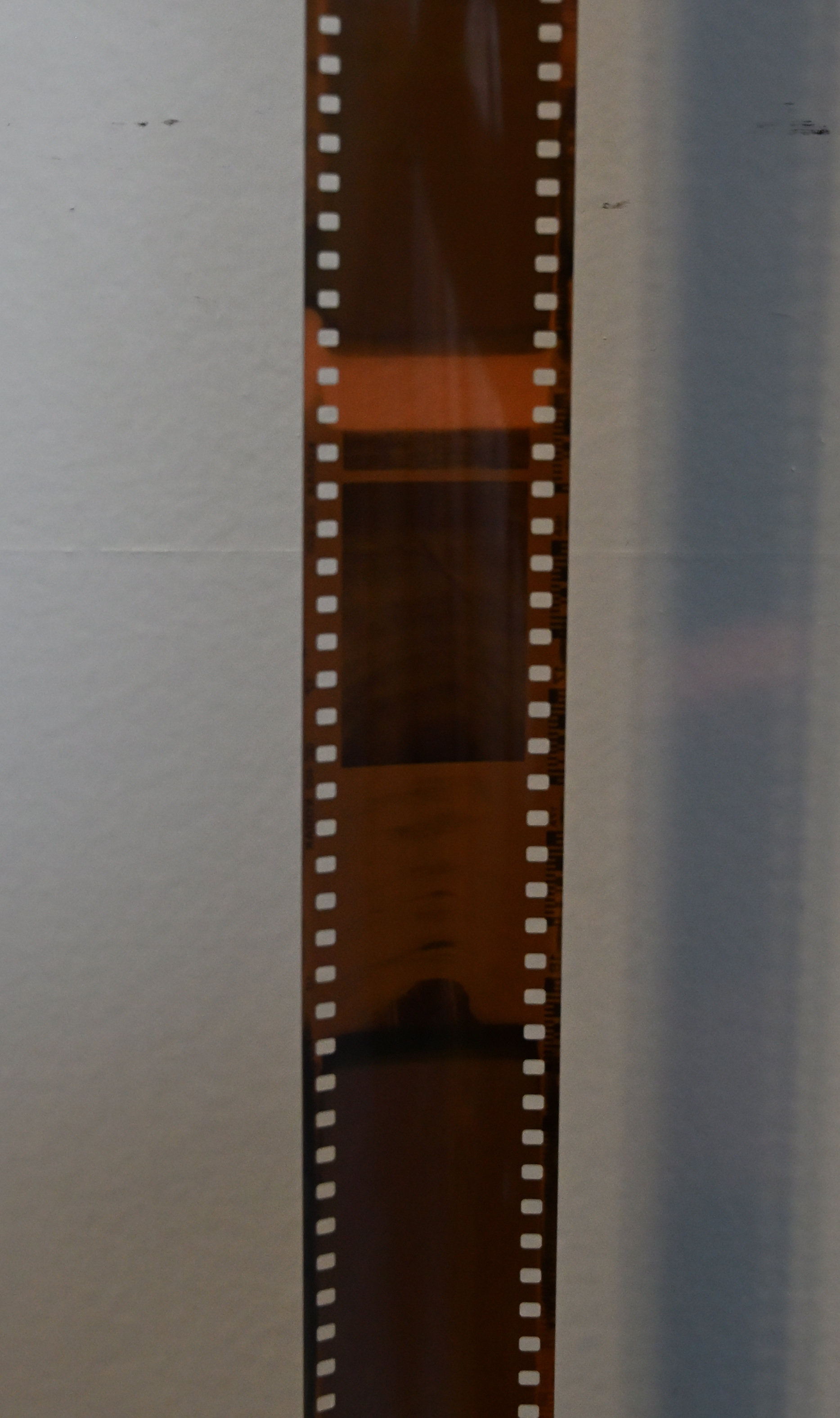

Hey y'all,
I've just finished developing a roll of Kodak GC 400 - 24 frames. It is an older roll, and the friend who shot the roll is very inexperienced (shooting on Auto on a borrowed Minolta X-700).
However, I fear the issue was caused in the development stages. There seem to be about 1.5 frames that came out okay, then half a frame is a pink line, then 3 frames greyed out, as if they didn't receive any development chemicals. It loops in this pattern, but the pattern is not lining up with my Paterson Reel (in other words, the length of the pattern is a bit longer than one spool of film wound in the reel), which makes me thing something else is going on.
Hoping anyone has any insight so I can not make this mistake again. Or maybe, if this is just some sort weird expiration pattern? I'm a bit stumped.
I developed using fresh CineStill C-41 chemistry, in my paterson reel tank.
Attached is a photo:

The film wasn't in the reel's track, causing it to touch itself, blocking development in the areas that touched. Try reeling in the light to get the hang of it, make sure the two ball bearings in your Paterson reel are present.

The dark areas appear to include the edges, and have a fairly sharp delineation that you would see with a light leak of some type, not the feathered edge of a chemical misadventure. They seen too long/far apart for a can felt leak, might your friend have opened the back of the camera a couple of times?
I have had old film that was worse at the beginning (and outer) end of the roll, more heat or cosmic ray exposure there? But this is nothing like those.

I don't think my friend opened the back of the camera considering he didn't even know how to do it. I'm attaching a higher res image of one of the transitory parts of the film

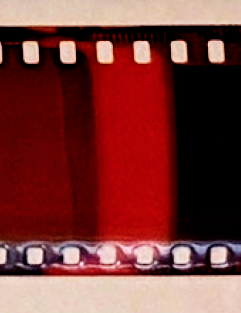

I suspect there are several problems going on at the same time here.
Note how on this bit, the b+f between the left sprockets next to the empty bit of image area is lower than in the section below it where there is a partial image. This can only be explained by a lack of development in that area. Note that development did take place on the opposite side, where there are edge codes and higher b+f. A similar pattern here:
What's interesting is how the undeveloped area is offset along the edge of the film, creating a C-shaped form. Also note the width of this band; I have the impression that it gets narrower towards one end of the roll.
Well, none of the frames look OK to me, but the ones that are quite dense may just be badly fogged and underexposed at the same time. The pink line is basically undeveloped (see 'C-shape' above). The lighter frames are developed alright, but less so than the others.
Note that you can use the length of these artifacts (no. of frames/sprockets) to figure out how large the diameter was that the film was rolled up on, which can then help determining at what point it happened. Doing this, I come to a roll diameter of around 70mm, which is in the ballpark for a regular processing reel. I also notice that the diameter is larger on the clipped end and drops away, which means that the clipped end went onto the reel last; I assume this is the end where the film was cut from the cassette during loading it onto the reel.

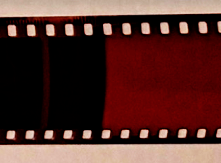

Then there's e.g. this bit:
Note how there appears to be fogging in particular around the sprocket holes. It's unclear what may have caused this; fogging around sprockets usually points towards problems with light leaks in the camera on the take-up spool area. But this is usually associated with higher degrees of fog in the image area than what we see in this bit.

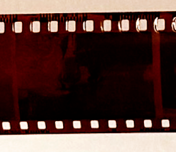

This is interesting, too:
There's an unprocessed bit on the top edge, left, which you often get on properly spooled film in a hand tank. There also appears to be severe fogging around the sprockets, but interestingly not (or less so) in the image area.
There's also this:
Note the irregular frame spacing. I'd be inclined to check other visible frame spacings to see how much variation there is, and especially if there are overlapping frames. This would suggest camera failure. IDK how this particular camera counts frames, but if it's an optical (IR) system, this could be a hint w.r.t. possible light leaks.
There's also this:
