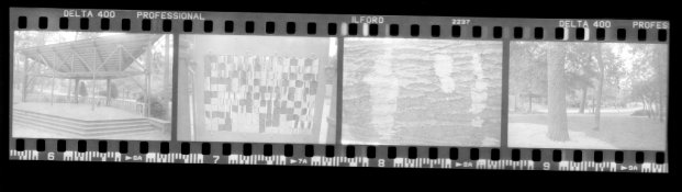

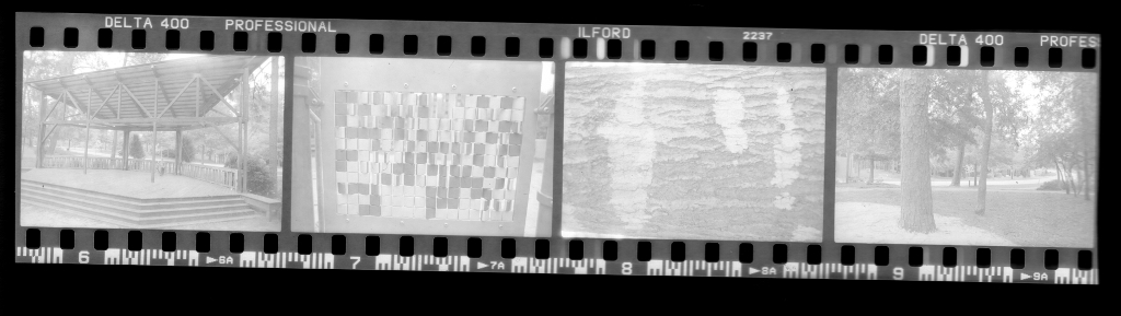

First Problem: Negatives are too dark / Positives are washed out and too light. Here's a raw scan:

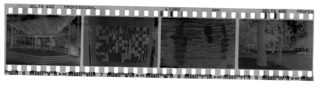

Here's the same negative with the colors inverted in GIMP:
I can't tell if these are underexposed or under-processed? I've only had one roll of film from this camera processed by a camera store, and they did a really terrible job so it's hard to compare.

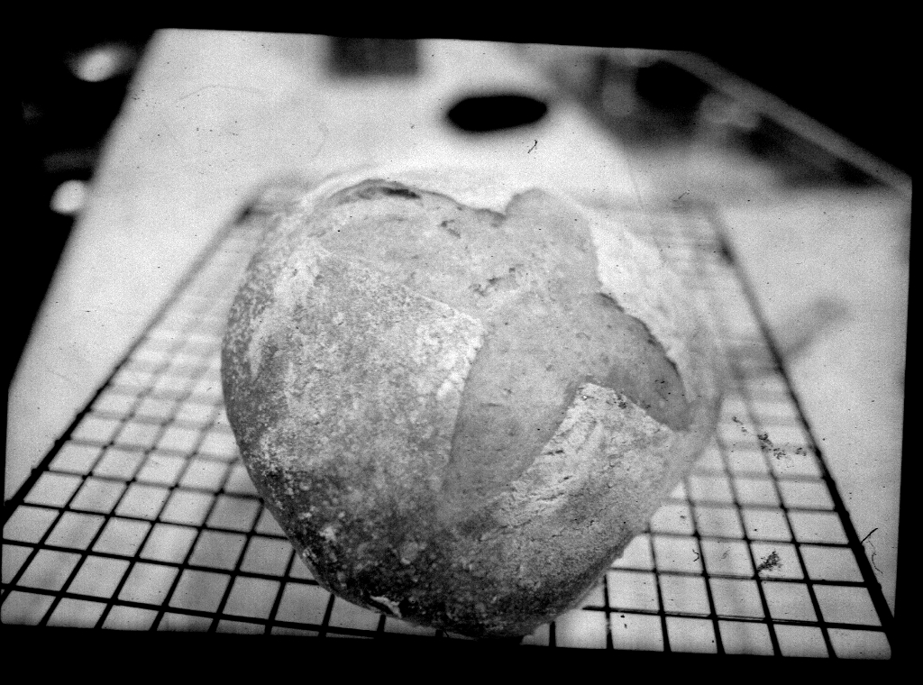

Second Problem: Weird black squiggles:
For this image I inverted the colors, jacked the contrast WAY up, then turned the brightness WAY down, and got this image which is pretty usable, but there are a ton of flaws in it.
Okay so it makes my pictures come out old and retro looking, but that's not what I was going for. I wanted clean images with no visible grain, and that's clearly not what I got. Part of it I believe is that the 400 speed film is a bit grainier by default than I expected. However I'm not sure why those little squiggles keep showing up. They showed up on the first roll as well. Someone somewhere suggested it might be dirt in the camera? Again I've not used this camera before so I have nothing to compare it with except my other camera which I use to shoot color that gets developed at my local C-41 pharmacy, and it has had no problems. It might be worth it to run a color roll through this camera and have it developed professionally to see if something similar happens. I'm worried though that this is the result of my developing process somehow. The negatives I had done at the photo store did not have these squiggles on them, at least not that I could tell.

The negatives that are a bit thick(dark) is a sign of overdevelopment. You can decrease the developing time or temp. It could also be that you over exposed in camera, but the film edges look a bit darker so I assume it's probably over development. Fog is also a possibility with expired or improperly stored film.
The lines may be scratches in the emulsion as they are black. Dust and dirt would be white when inverted on the computer or wet printed. You would want to check with a loupe. If you don't have one a camera lens filpped works fine, or even a simple magnifying glass.
Over development would result in increased contrast, highlights would increase in density but shadows would not.
This appears to me to be over exposure. Contrast is not too high (might even be a little flat) and shadows are full also.
The rebate area looks a bit fogged too, which could confuse the exposure issue and would flatted the effective contrast (shadows would be fogged as well, making over exposure difficult to say for sure).
Also, one software's "raw scan" may not be the same as another's.
If it is overexposure, would over-developing help compensate? Someone else also mentioned that temperature could be an issue, which struck a chord because the room I'm developing in is only tangentially heated to around 16-18°C, and it's entirely possible the developer is cooling faster than it should. My next step was going to be processing at that room temperature with the proper time adjustments to avoid major temperature fluctuations.
Yes, it does look fogged. And there are sprocket hole "shadows" visible near the imprints "ILFORD" and "DELTA" that might indicate a general light leak. Which might help explain that apparent fogging. Note that those shadows are also mirrored more faintly directly below on the bottom rebate.
There is also another fainter sprocket shadow beneath "PROFESSIONAL". Fainter would mean that those frames were wound quicker between exposures, while darker would mean those frames sat in the same place longer between exposures.

The 'black squiggles' are dust that was on the film at the time of exposure, which would have stopped light reaching the film. if it were dust on the negatives at time of scanning they would show as white squiggles. It could easily be dust in the camera, in which case clean the film track with a lightly-moistened cloth or fingertip (but DON'T touch the shutter curtains!) or gently blow it out with a can of Kenair, then clean your camera bag or 'never ready' case.
If the film was bulk-loaded, it's possible that the dust landed on the film during loading. I find it's best to avoid film bulk-loaded by others; it may be cheap but I'd rather have clean negatives - your mileage may vary.

I agree that the squiggles look like dust on the film at the time of exposure (they look like cotton to me, though I can't guarantee it).

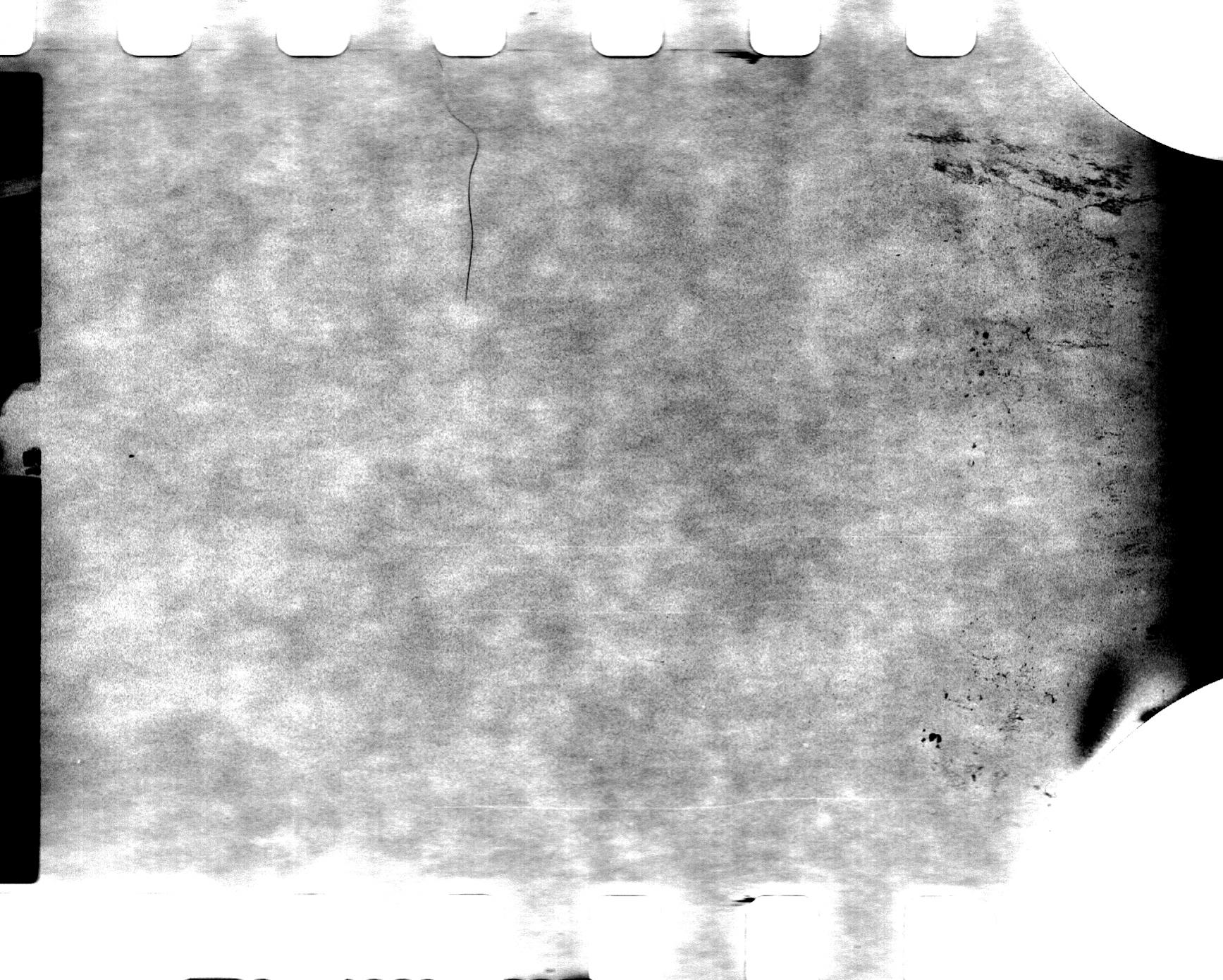

A word about my scanning process, as mentioned above I'm using an Epson Workforce 500 flatbed at 1200 DPI (the max it will do), placing the negatives on the bed, covering them with semi-gloss freezer paper, and then placing a iPad displaying all white on top of this. The results have been usable, as I'm only trying to digitize these photos to share with friends online. I'll make prints the old-fashioned way sometime in the future.
Do you have a loupe to check the negatives? If not a 50mm lens can work as well. See if the squiggles are on the film. My assumption is they are since they would be white if it was dust during scanning. The fact that they are sharp makes it look like dust on the film. Have you looked at the inside of the camera? is it clean? Are you using bulk loaded or factory loaded film?
I'm goin' with a dirty camera for the moment for the dust. As suggested, a good cleaning might help, but I would use compressed air or a rubber air blaster (be careful for liquid stuff being expelled). Lens off, mirror up, open the back, where the film is, etc. I do mine occasionally and never have this kind of dust.
I wouldn't be the least bit surprised if the dust and squiggles are due to your rather unorthodox scanning method.
Try scanning the freezer paper with just some clear, unexposed film, and see what you get.
Agree. I'd try it without any film... then without the freezer paper...
In my experience, traditional films look much grainier scanned with a flatbed (I use a Epson 1640) than printed.
Case closed. I don't have a loupe but examining the negatives against a light they looks much better than the scans would indicate. Again I'm not that upset since these are just destined for Facebook and Tumblr until I can get into a darkroom, but I'm glad to know it isn't a problem with my camera!
