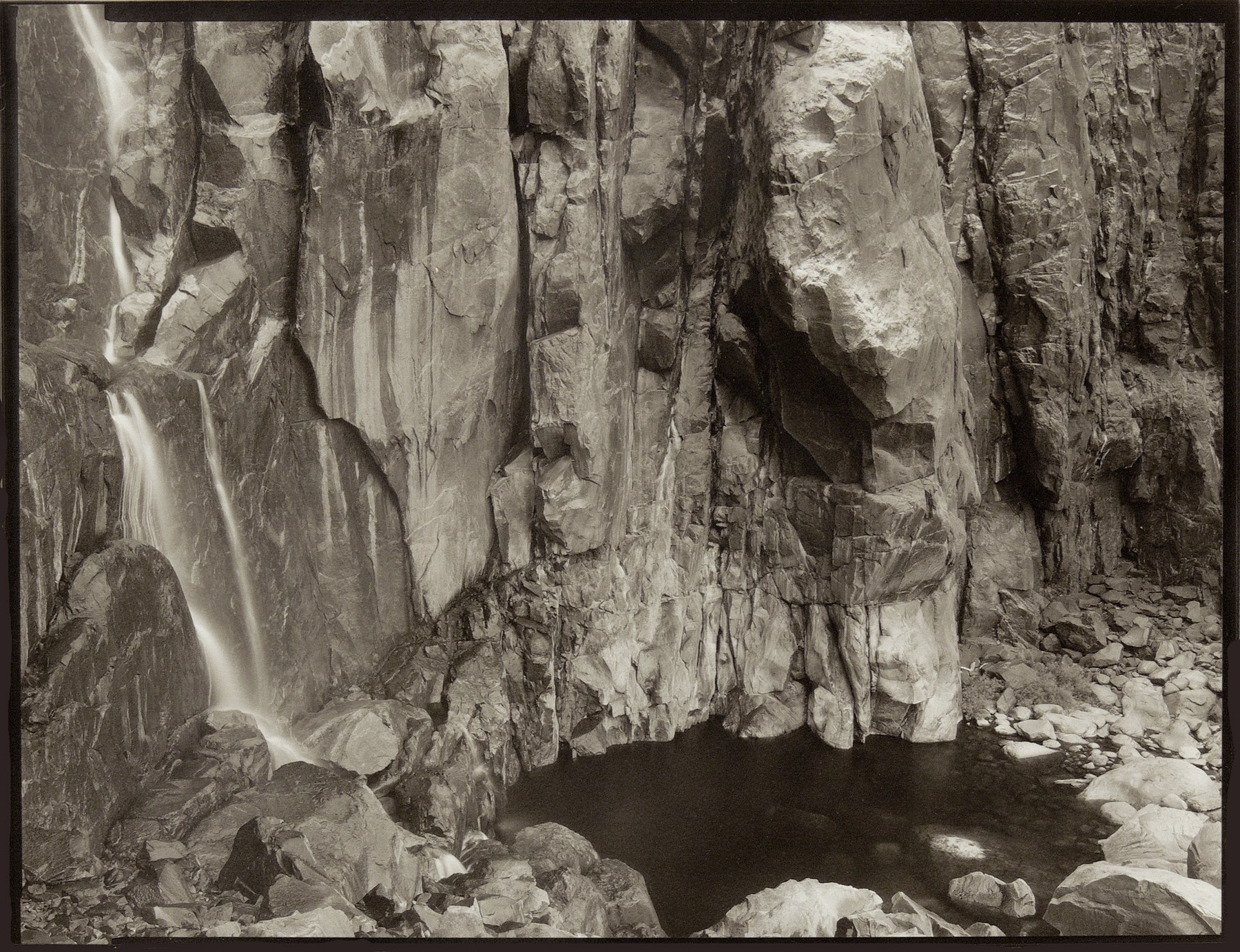

The Ivory Black watercolor that I have tried has been much warmer, and not a opaque, as Lampblack...but there will be differences between brands, too. I appreciate a little warmth in my prints sometimes! Carbon print, 8x10:
Thank you! Beautiful image!
