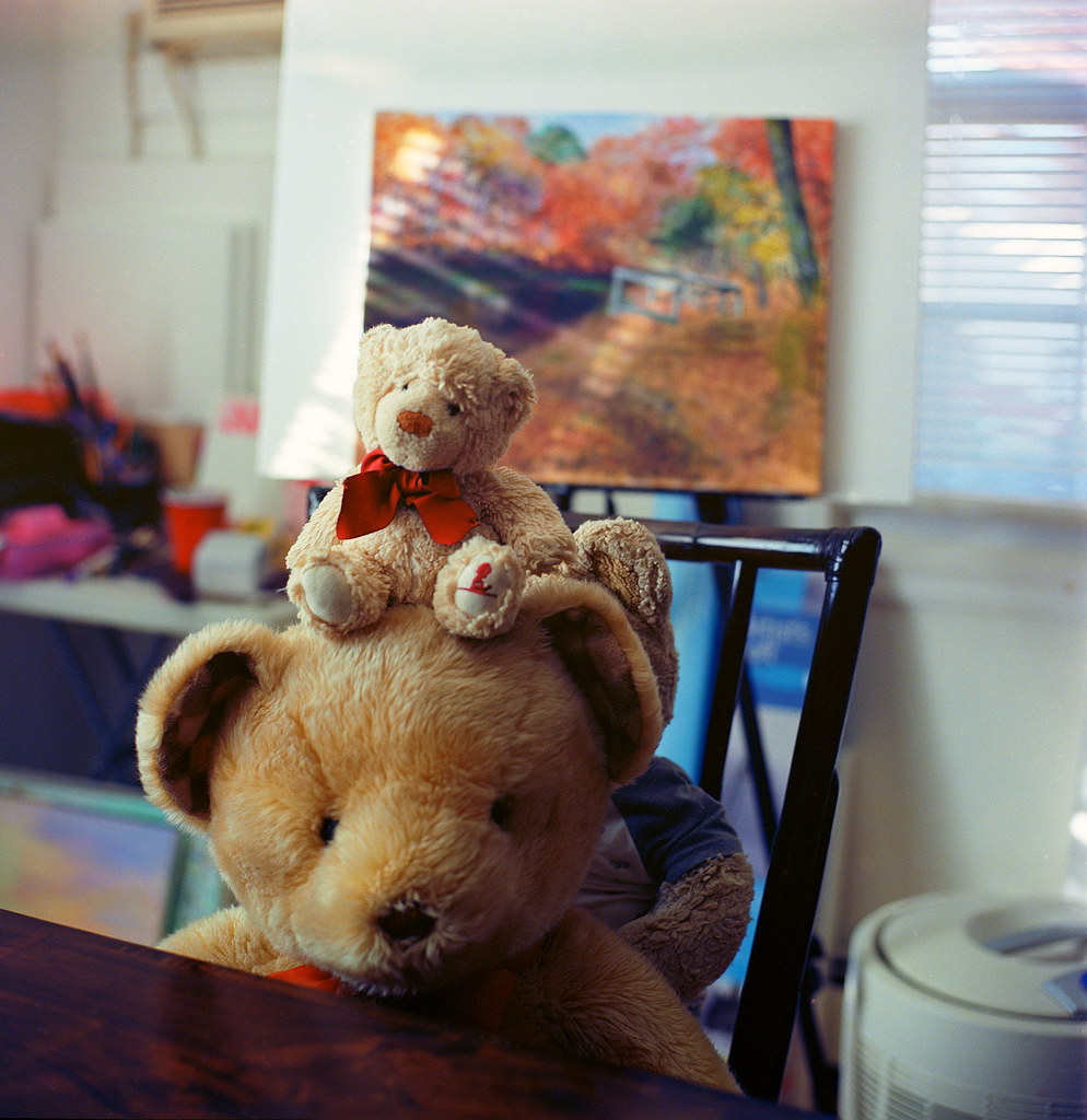

The Carl Zeiss Hasseblad 80mm is sharp...this shot was taken at F5.6 1/125s. 553 elx Hasselblad 80mm f2.8 C T. Ektar 100. Tetenal C41. You can click on the photo and look at the flickr larger version, 3000 pixels. The original size is 6000. You can see cracks in between each bricks with grains of course.
rawvideostore by vracing, on Flickr
Same roll at wide open, 1/60s. The focus is on the small bear. Is a bit soft due to lower light and slower shutter speed and shooting at wide open.
rawbears by vracing, on Flickr
I thought you outsourced your scanning and developing to a third party. :smile: Depending on what scanner you are using, a 6x9 negative would appear sharper than a 6x6 if you are using some low, low end scanner. BTW, I DSLR my "scan." That's all I would say about the scanning subject. The subject is too complex and complicated to be discussed in this thread here.
