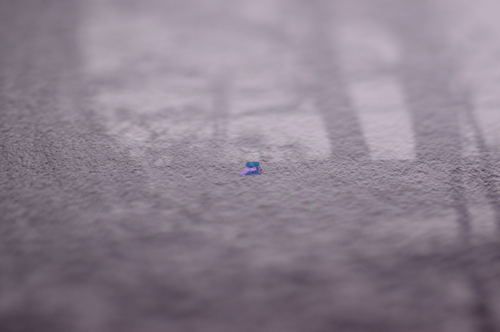

A few hours ago I was about to start flattening all the dry prints from the previous days work in a mounting press. As a routine, I always check that the prints are completely free from particles, which will otherwise damage the surface. This was when I noticed that in some (about 25%) of the prints there were one or several small (ca 2 mm), approximately rectanglar areas reflecting a greenish-purple sheen. These imperfections were not visible unless looking at the prints from an angle.
I tried to resoak one of the prints in hope that the sheen was from some water soluble substance, but as soon as I removed the print from the bath and let the water run off I could tell there were small "swollen" areas in the same places where I saw the reflections in the dry print earlier. My guess is that the coating is damaged in some way.

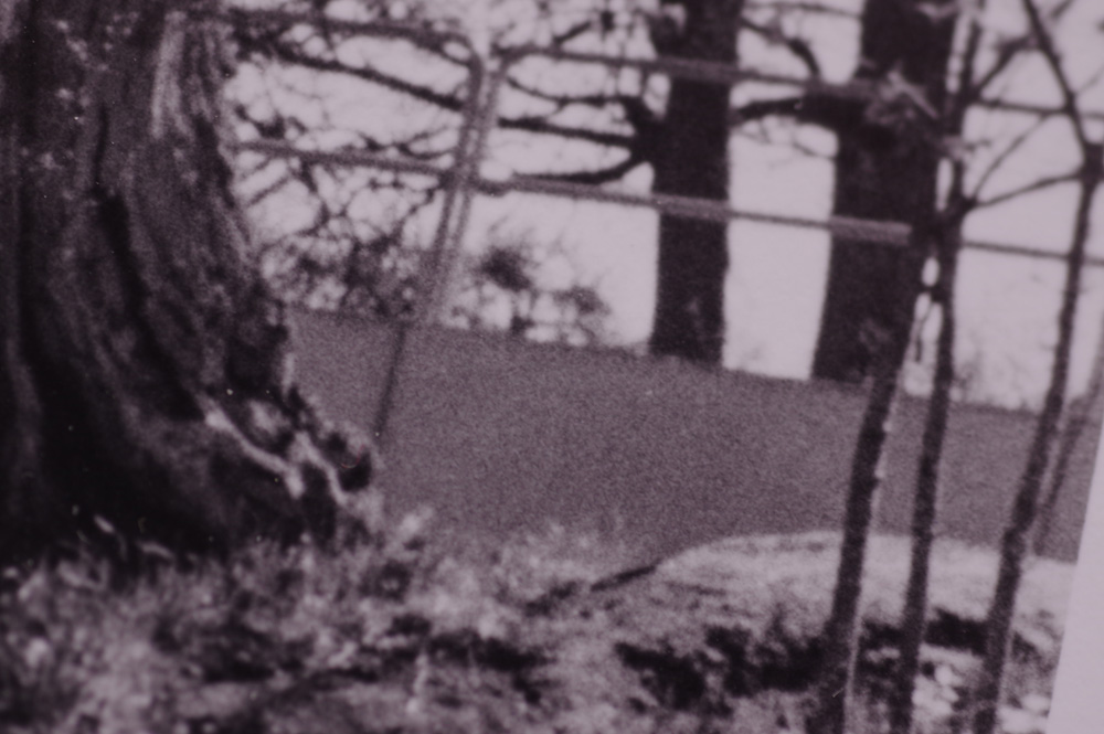

Enclosed images: Same part of damaged print photographed straight on (above) and with light reflected from the surface (below). Several prints had 2-10 damages of this type, all of them a few mm long.
