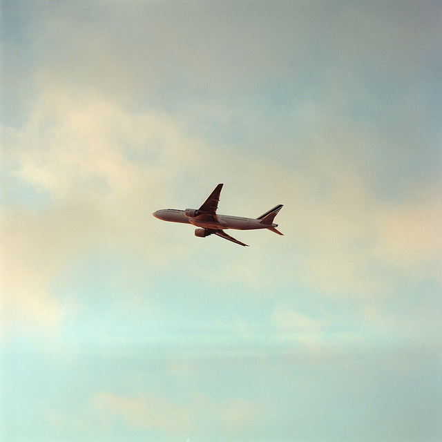

Occasionally I have been having issues with over-development, discoloration, or both on a single frame of a 120 roll. I'm not sure exactly what is causing this as I don't have things like this happen when I develop black & white, it seems to only happen with 120 film in c-41 or e-6. I am using a Paterson Multireel 3 tank and do pre-wash my film. Has anyone seen something like this before and what could be the culprit?

Can you say what it is that is wrong with this and is it a scan of a neg or scan or a print? You may have gathered already that I really cannot see anything really wrong. There may just be a hint of a red/magenta cast but there may not. It depends on the light that is reflected from underneath the plane.
If the rest of the negs on this film are OK then I cannot see how processing is at fault.
Are there other negs you could show us that have a bigger range of colours and form a larger part of the frame. A picture of mainly sky and a largely one colour object which is the plane may not be the best frame to use to illustrate the problem.

pentaxuser, there are clearly visible horizontal cyan streaks between plane and lower frame border. I have had similar streaks with C-41, also only with 120 roll film but never with 35mm film, and these streaks went away for good when I started using a stop bath after the CD step.
If seven10 has similar streaks with E6, he could try using a stop bath after FD. Since CD runs to completion in E6 processing, there is no need for stop bath after E6 CD or any of the later steps. Any B&W stop bath will do, be it Acetic Acid or Citric Acid.

Thanks Rudeofus, I will try using some of the stop bath I have. I never thought of that before. It's odd, but this issue pops up very randomly. The only thing that has been consistent about it is that it seems to happen on frames closer to the center of the reel.

Rudeofus, you may well be right but how does the stop bath problem affect only one frame? I cannot work out how a stop bath "washing the whole film" as it were can affect only one frame.

The effects which I got successfully under control by using a stop bath were mostly confined to homogeneous regions on the film. If there was some landscape with blue sky, only the blue sky would show the yellow streaks.
seven10, can you tell us whether the other frames contain similar or different subject matter?

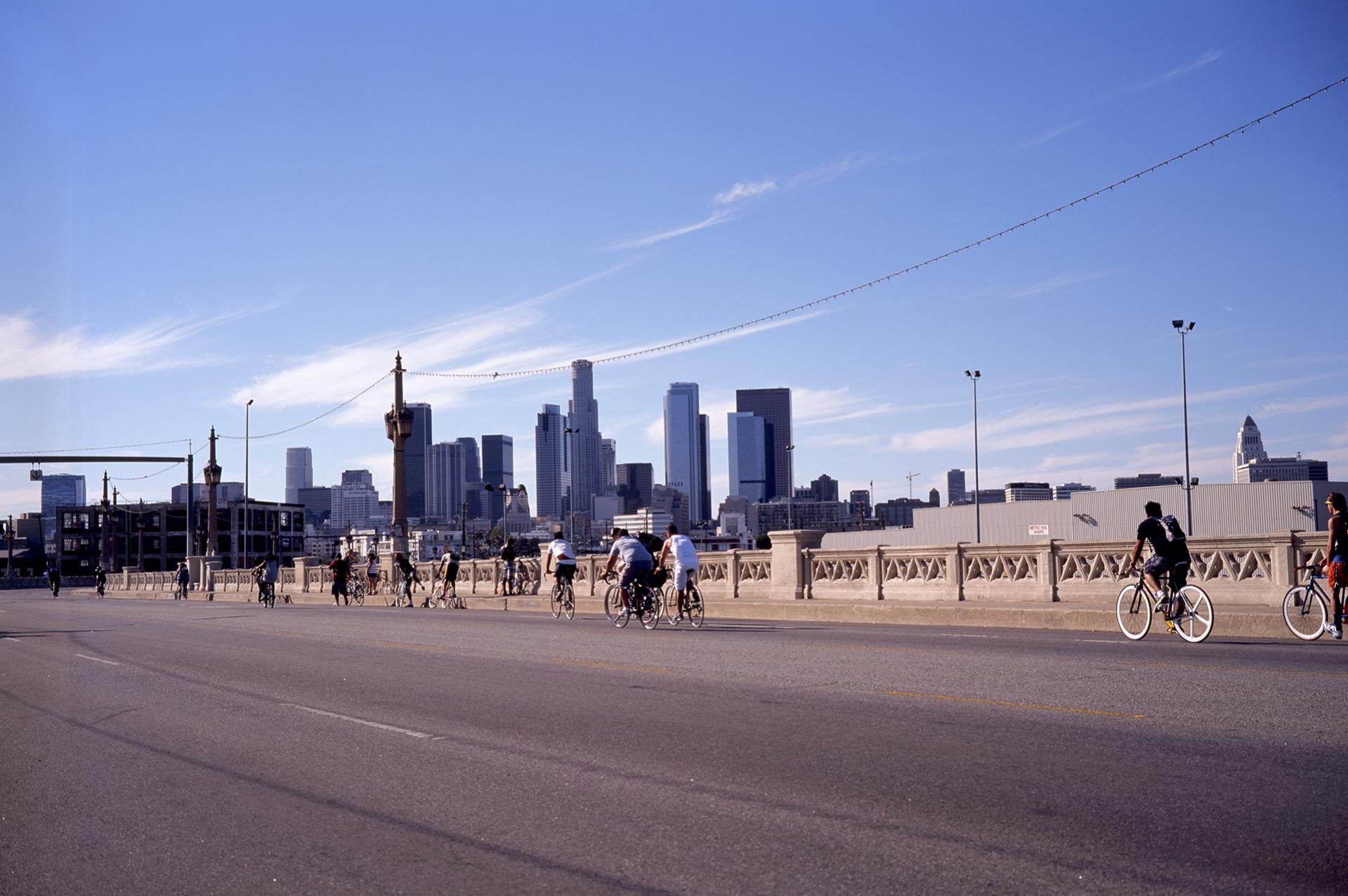

I found one of my earlier slides that shows a similar line to the left side of the frame where the development went awry. I'm hoping that the stop bath step will help eliminate this from happening too.

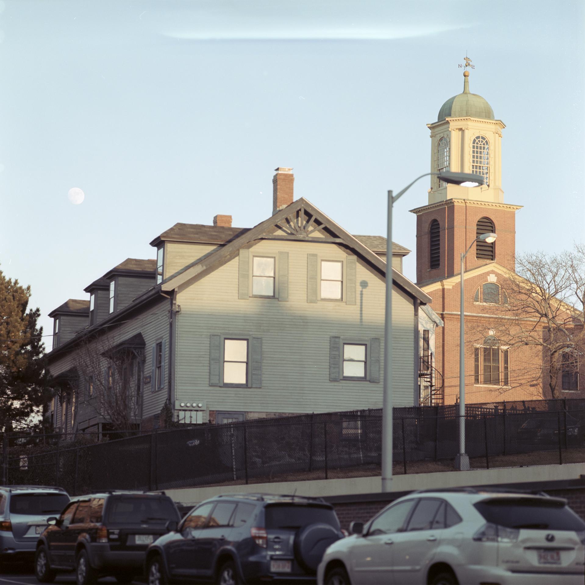

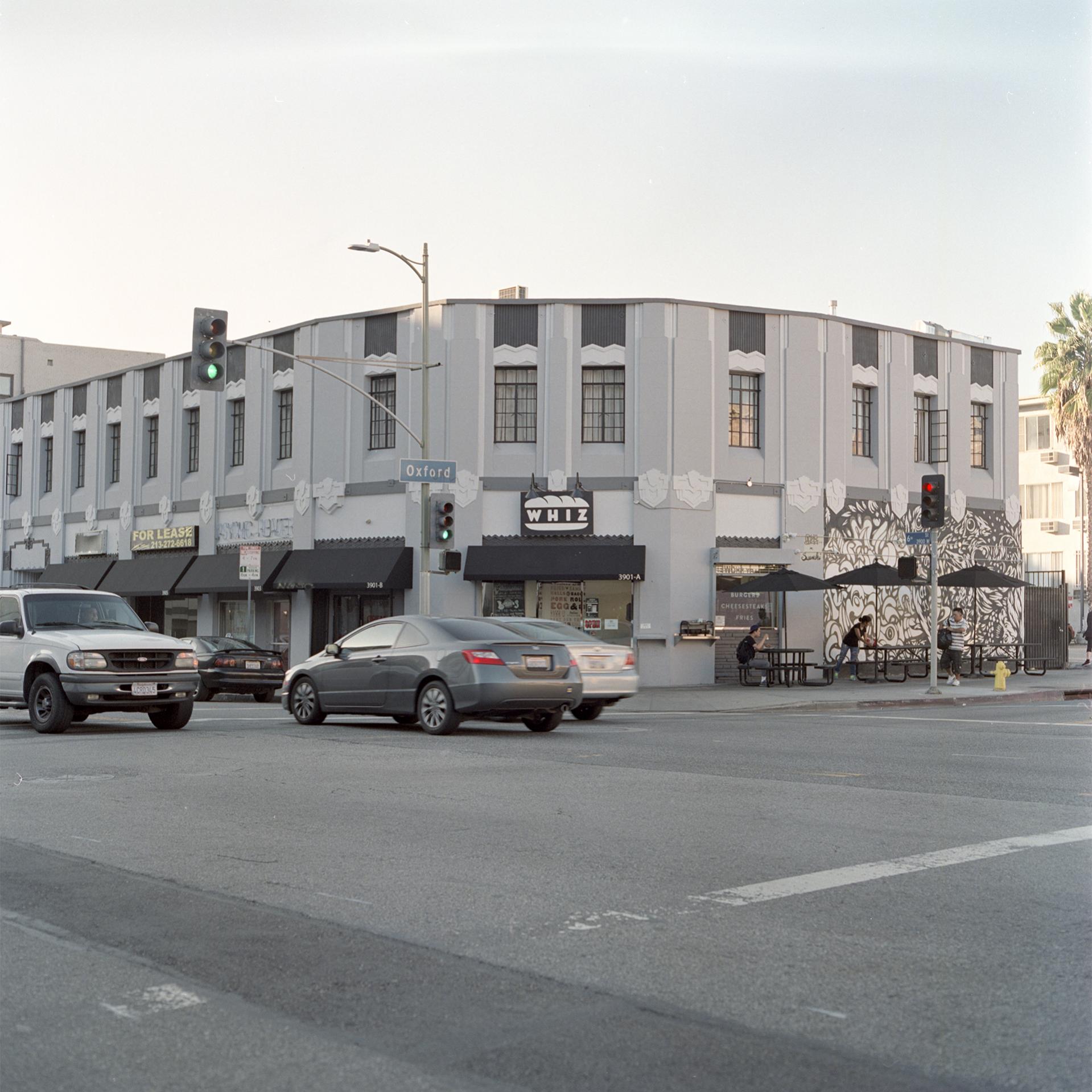

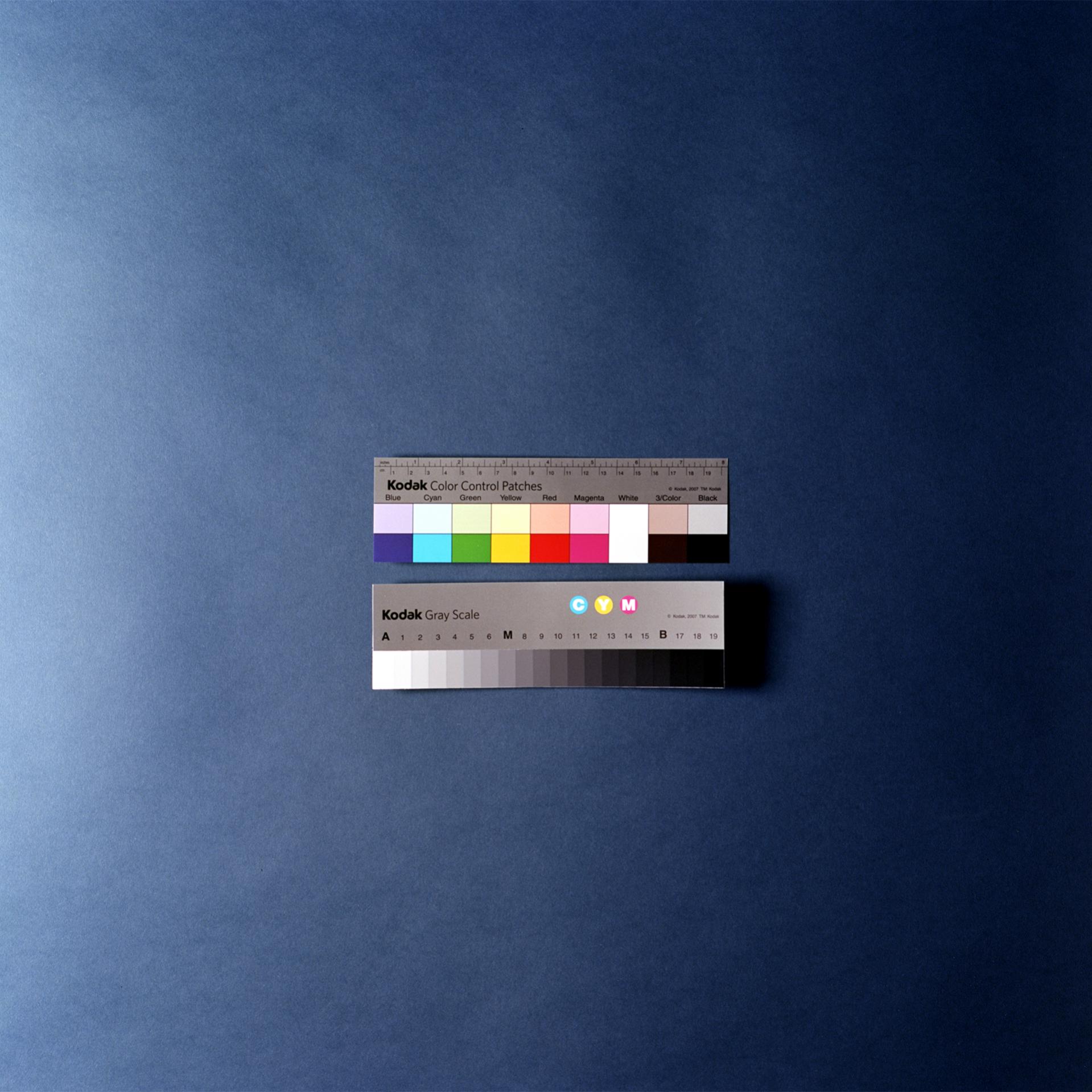

I am resurrecting my original post. Despite adding a step for a stop after the developer and before blix I am still getting some rolls that have a line of over-development. I'm not sure exactly why this randomly happens though, as soon as pour in the developer I agitate immediately via inversion and I have tried agitating with the twirl stick thing. When the line does show up it's almost always on the 10th frame when shooting 6x6. Any ideas what I should look at next?

If this always shows up in frame 10, I would strongly suspect there is something wrong with your camera.
If you come to the conclusion that it must be processing (e.g. because B&W films you processed in the same setup don't show this effect), I can give you some methods to track down the problem. For this you need to separate the steps involved in C-41 processing and make intermediate steps observable. If done correctly, all images can be salvaged after these tests.
First, let's find out whether the BLIX still causes trouble:
  1. Take a roll of normally exposed C-41 film and put it in your tank as you always do
  2. Do the normal color development step as you always do
  3. Optionally use stop bath
  4. Fix the sample with standard B&W rapid fixer
The resulting colors will be way off, because there still is all the developed silver in your film. Nevertheless, this retained silver does not affect the visibility of the streaks you get (or don't get now). If the resulting film doesn't have these streaks, you know it's the BLIX that's causing trouble. Either way, you can now BLIX/wash/STAB the film and get normal negatives, nothing will be lost.
If you see these streaks after the procedure listed above, you could investigate the color developer:
  2. Develop it with regular B&W developer. There are many threads about how to do this, look them up for proper development parameters.
  3. Use regular stop bath and B&W rapid fixer and inspect the resulting negatives.
You should have a B&W image superimposed over the orange mask. Tell us whether you see streaks. You can salvage the negatives by bleaching them in a rehalogenating bleach (no BLIX!!! ), then running them through the regular C-41 process.

The artifice in last two frames looks like a light leak (or flash of the interior) please could you tell us what camera you were using, and how deep a lens hood.
If you have another 120 camera Id use it instead
If you are agitating by inversion you need to use the minimum amount of liquid to just cover the reel.

I can rule out this issue being the camera(s). It has shown up when using my Rollei, Hasselblad, and others. I gave the frame location since it seems to occur around that same place on a 120 roll independent of camera.
When spooling 120 onto a Paterson reel do most people keep pushing it on until the tail has moved past the bearings? I'm wondering if films that have a really curled tail are creating more of an air pocket there, though I don't see this same issue when I develop b&w but I wonder if that's because development times are much longer than c41 or e-6 usually.
