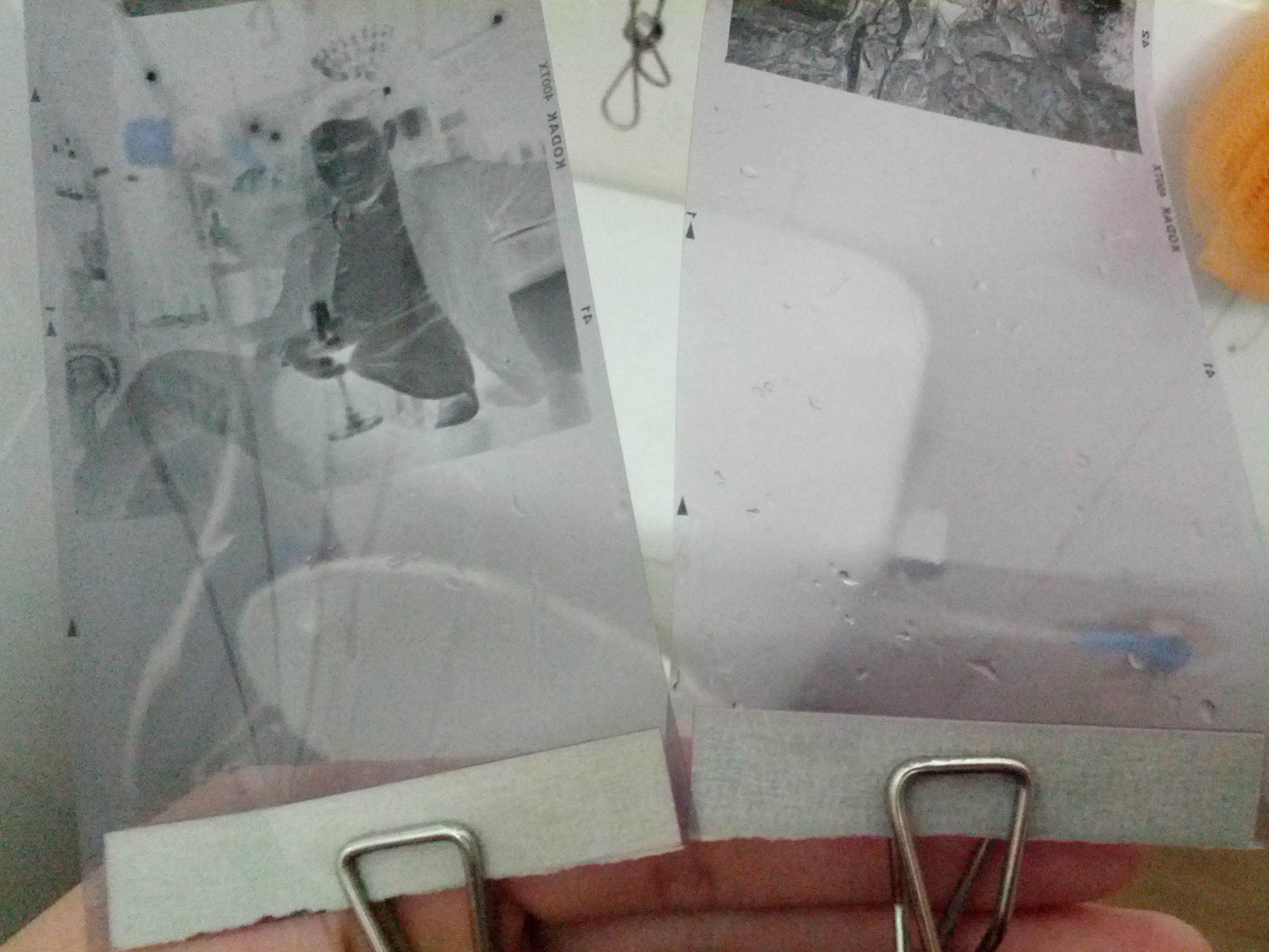

Today I loaded two rolls of TriX 400 120 of two clients in one reel and developed them with Xtol 1+1, stop using water (three changes), two bath fixing using Kodak fixer (hardener), wash, then Hypo clear 1+2 for 10 min, then wash for 45 min. I did pre-soak for 3 min before developing.
It turns out that though they are the same film, they have different bases! One is still slightly purple, and the other one is more clear (a tiny bit grey to my eyes). Both is in-date. Ok, how come???

Sorry for the bad quality picture from my stupid phone. It still shows the difference I believe.

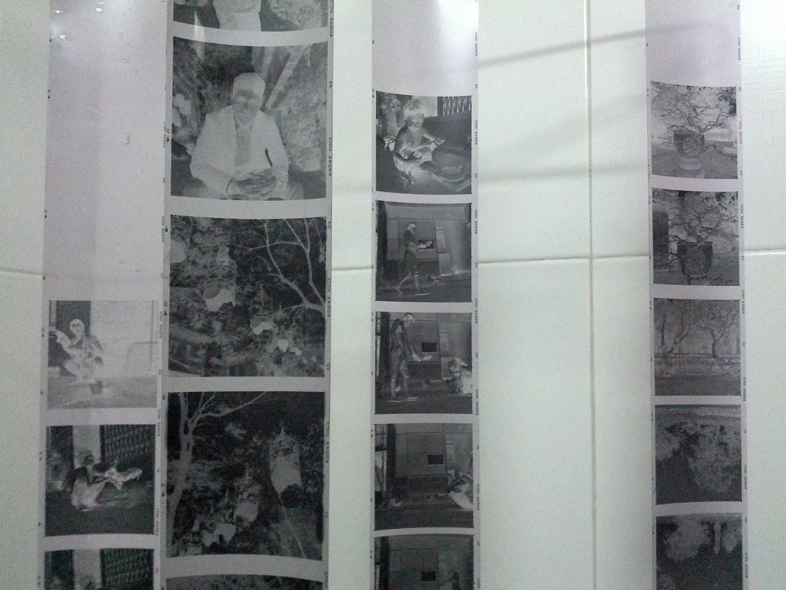

Actually I also processed two more rolls for the client who has the purple-ish TriX. They have the same slightly purple base. There are still 18 rolls to process, and I think they will have that base too.
In the pic, all three are the further, the other more clear TriX is the closer.

Different batches? Different expiration dates? I don't know about you, but I love the purple! Me, I'd be disappointed to see my Tri-X w/ a clear base after all these years.

I wouldn't worry about it. It is not harmful to the film, or to the printing afterward. You did nothing wrong.

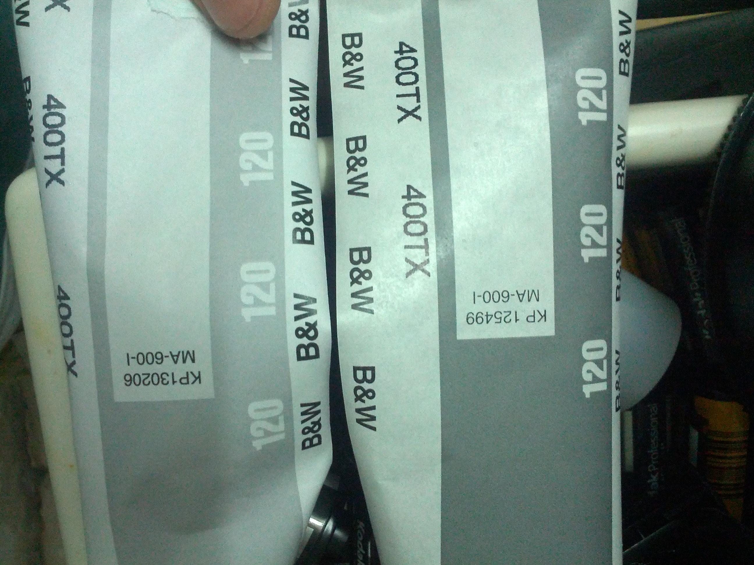

I dont worry, just curious. Yep, their backing papers are different. The purple's paper is more white while the clear one is a bit grey.
There is also a code on the paper, probably batch code because all purple rolls has this same code KP130206. If so, the purple ones should be the newer/fresher batch.
I also think the purple one react with developer better because its density is more than the clear one (actually I feel it's a bit grey not really clear which might be the sign of fog), based on the density of the frame number on the edge.

This has nothing to do with base color, backing paper or whatever. What you see here, is an issue frequently referred to as "TMAX magenta cast", which has shown up on Tri-X for at least a few years. There is even a sticky about this in this very subforum. As Thomas Bertilsson already stated, it is nothing to worry about, but if the magenta cast becomes stronger, you should refix with fresh fixer, then rewash.

I just developed a roll of this (still drying atm), and I agree with Rufeous. It's a fixing issue. Now why one would should it and not the other in the same tank I'm not sure of, but I'd lay odds that your fixer is deteriorating.

Today I made a fresh 600ml working solution of that expensive Ilford rapid fixer, fixed two rolls for 3 min. After 1 hour washing, there's still lightly purple base. How could that be a fixing issue??

PE once stated that different batches of film receive slightly different coatings. Sometimes an emulsion turns out more sensitive than it should be and is then tamed with special adjustment layers for consistency. I have no idea whether these adjustment layers are coated as neutral density filters, or whether different colors of the light spectrum are measured and corrected. Either the extra coating, or the variation in the emulsion itself could cause these variations between rolls.
Kodak's own literature states, that a slight magenta hue will not have an adverse effect, therefore jumanji doesn't have to worry about it. It will go away if he leaves the film strips in broad daylight for a few days.

I recently had problems with retained dye in TMax 400 sheet film (TMY). The color cast was very dark. See this thread for the entire description and photos.
Summary: I needed to give a treatment in an alkaline bath to get rid of the retained dye. If your color cast is being stubborn, you may want to try that as well.
