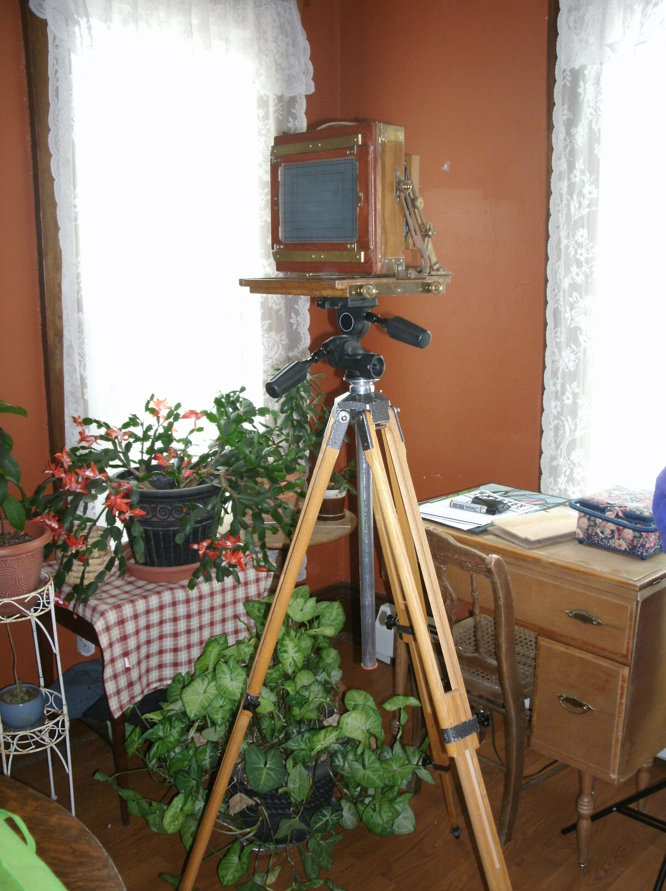

Here's my Dorffclone on my old Berlebach Report tripod using the PHT-2 head. Great tripod but not as convenient to use as the Induro or Vanguard.
