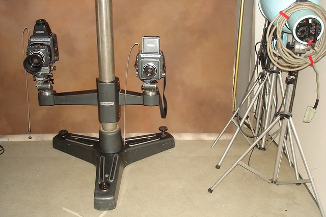

DSC05778 by Nokton48, on Flickr
I bought this Plaubel Profia Camera Stand for a hundred bucks at Midwest Photo Exchange. Would you believe they had six of them at the time? Every studio needs a good camera stand.
