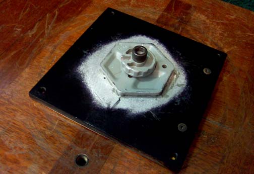

I used my existing tripod w/ bogen 3047 quick mount plate. I have the 3047 plate welded to a 6" chunk of 1/4" think aluminum from a nuarc process camera lens board. If you want pretty this aint it but it is very stable and works great for me. I did replace the standard 1/4 - 20 thread with a 3/8 bolt that fit right in the mount plate and is permanently screwed to the camera base. Its ugly but you could make it look nice if you wanted to.
