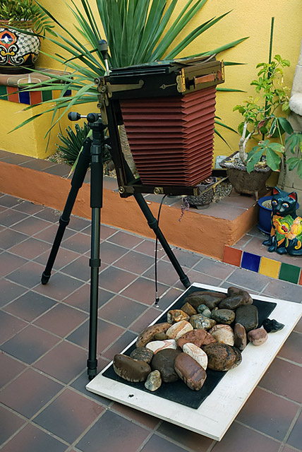

I have an Eastman View 5x7 and an 8x10 2D, and was also finding that many pan/tilt heads were not very stable or secure enough for these cameras. I wouldn't even consider using a ball head.
My tripod is more than sufficient for the 8x10, but I realized I needed a head that positioned the camera as low to the top of the tripod as possible to be stable.
I found a used Gitzo G1570m 3-way head for about $150, and it's been perfect. I don't need a quick-release anyway, and it's got a nice large platform for the camera base. Good damping on the movements and locks down as tight as you will ever need.
