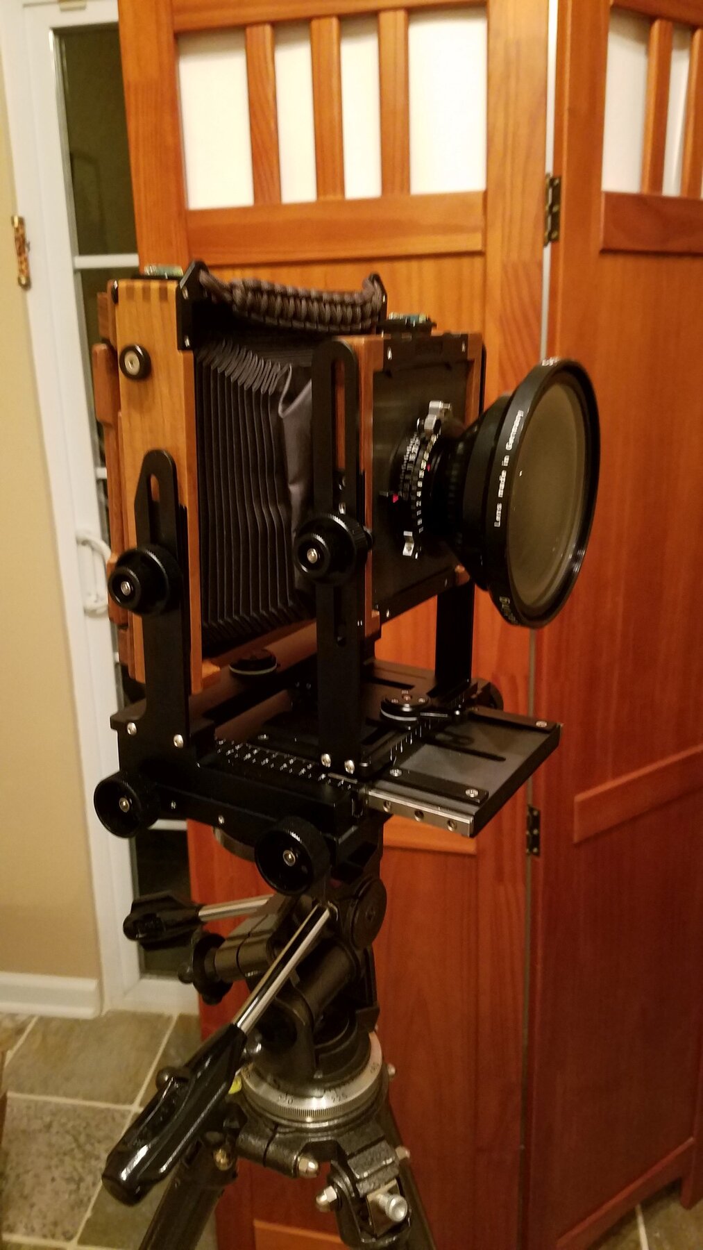

I'm using my medium-format (Mamiya RB67) 40-year-old Gitzo tripod with my Chamonix 45H-1. At 9 pounds including the pan and tilt three-way head, it's overkill. But it takes an earthquake to move it.
