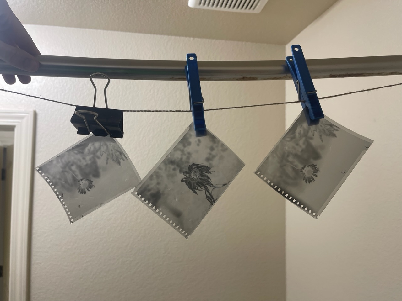

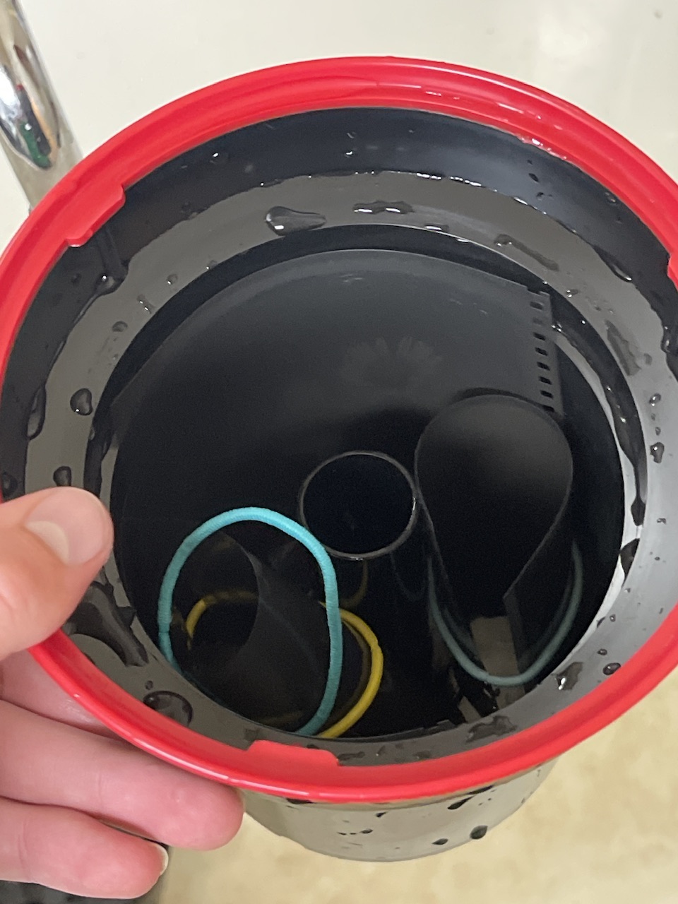

So, I tried the taco method. It failed spectacularly.
I was super worried that it was going to be a complete disaster, but thankfully, it turned out alright:
Anyway, I’m looking for an actual 3x4 tank so that I can develop sheets without fear that this mess will happen again. Any suggestions?

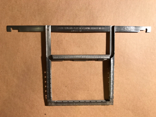

Old 3x4 sheet film hangers can be had cheaply on Ebay, but you'd have to find/fabricate at least 3 tanks and process in the dark.
Just be sure the tanks hold the minimum required developer amount, which I think is around 250-300 ML per sheet and use them one-shot.

I don't know the 3x4 tank answer - I think Nikor 4x5 reels are adjustable for height. Smaller/tighter hairbands might help with the taco method. Also, it looks like your film clips are clamping the film well inside the image area when hanging. Try clipping on a corner with the perfs, and just kissing the corner of the film.

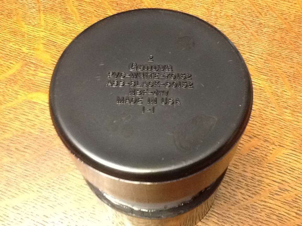

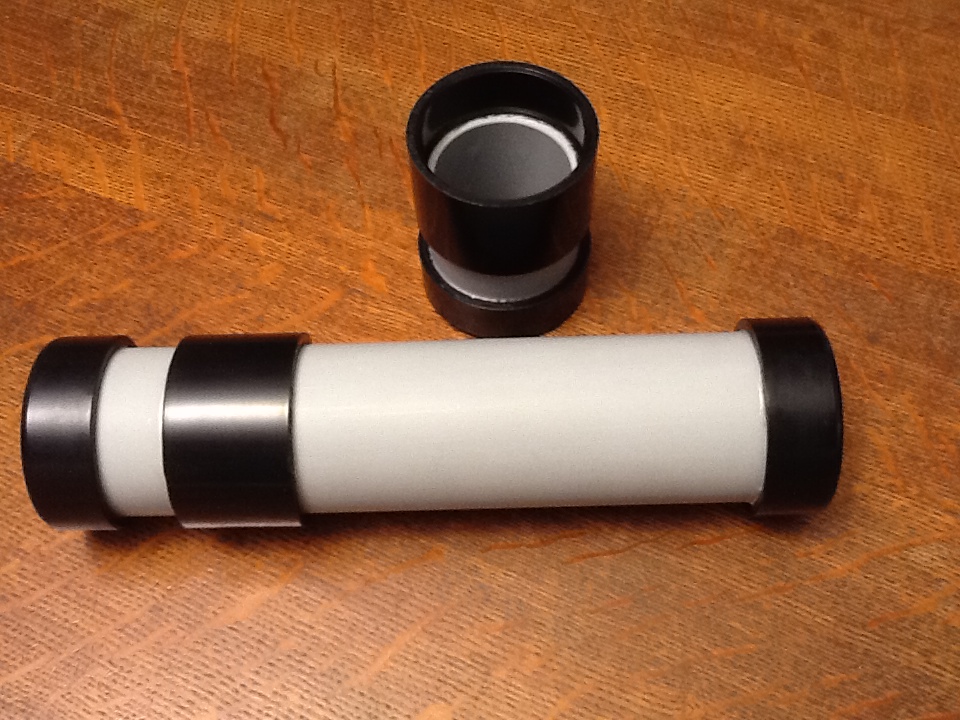

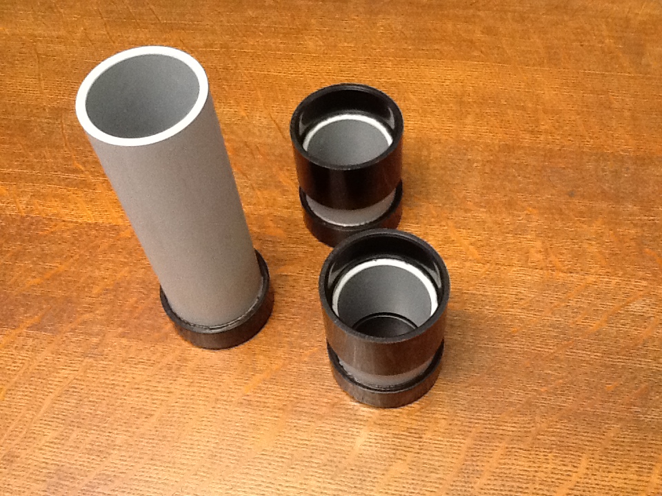

That was my thought, 4x5 tubes should work fine with 3x4. The View Camera Store has some good videos on YouTube on how to use them. You can buy tubes or make them. Very economical on chemistry.
Roger
Can I make them from PVC pipes from the hardware store? Or do they need to be made in a special way?
Jobo Expert Drums provide flexibility with reliable consistent processing.
Unfortunately, they also blow up my wallet.
Roger Thoms
Nov 18, 2007
1,797
Flagstaff, AZ
8x10 Format
I used grey pvc electrical conduit and abs couplers and caps for the 5x7 tubes I made. I’m traveling, but will post a few photos when I get home on Thursday.
Roger
Lol, have photos on my phone already.
