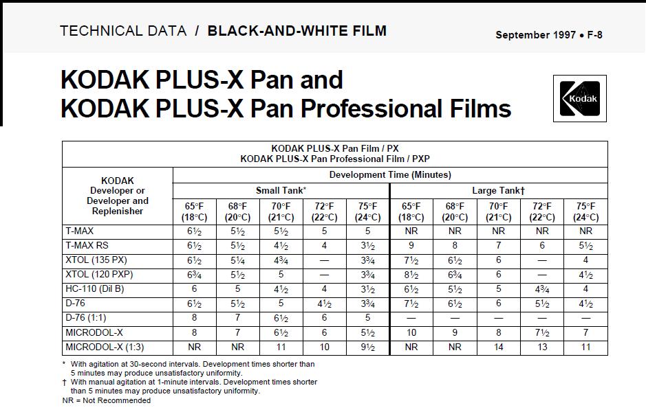

Here's the F8, September 1997 Data Sheet I inadvertently used. (For historical/archival purposes. Do not use!)
  • f8.pdf

Hmmmm, looking at the Massive Dev Chart, the times are for the older film. (There is a note to that effect in the Massive Dev Chart, but it also says that starting times are the same.)
This is a good reminder to find the most recent manufacturers' info you can.

The older version of the film is the one referred to in the 1997 data sheet you linked to - it is called "KODAK Plus-X Pan or KODAK Plus-X Pan Professional film".
The newer version of the film is now known as "KODAK Professional Plus-X 125 film" and the Kodak data sheet for it is f4018:
http://wwwcaen.kodak.com/global/en/professional/support/techPubs/f4018/f4018.pdf.
That data sheet highlights the differences between the versions.
