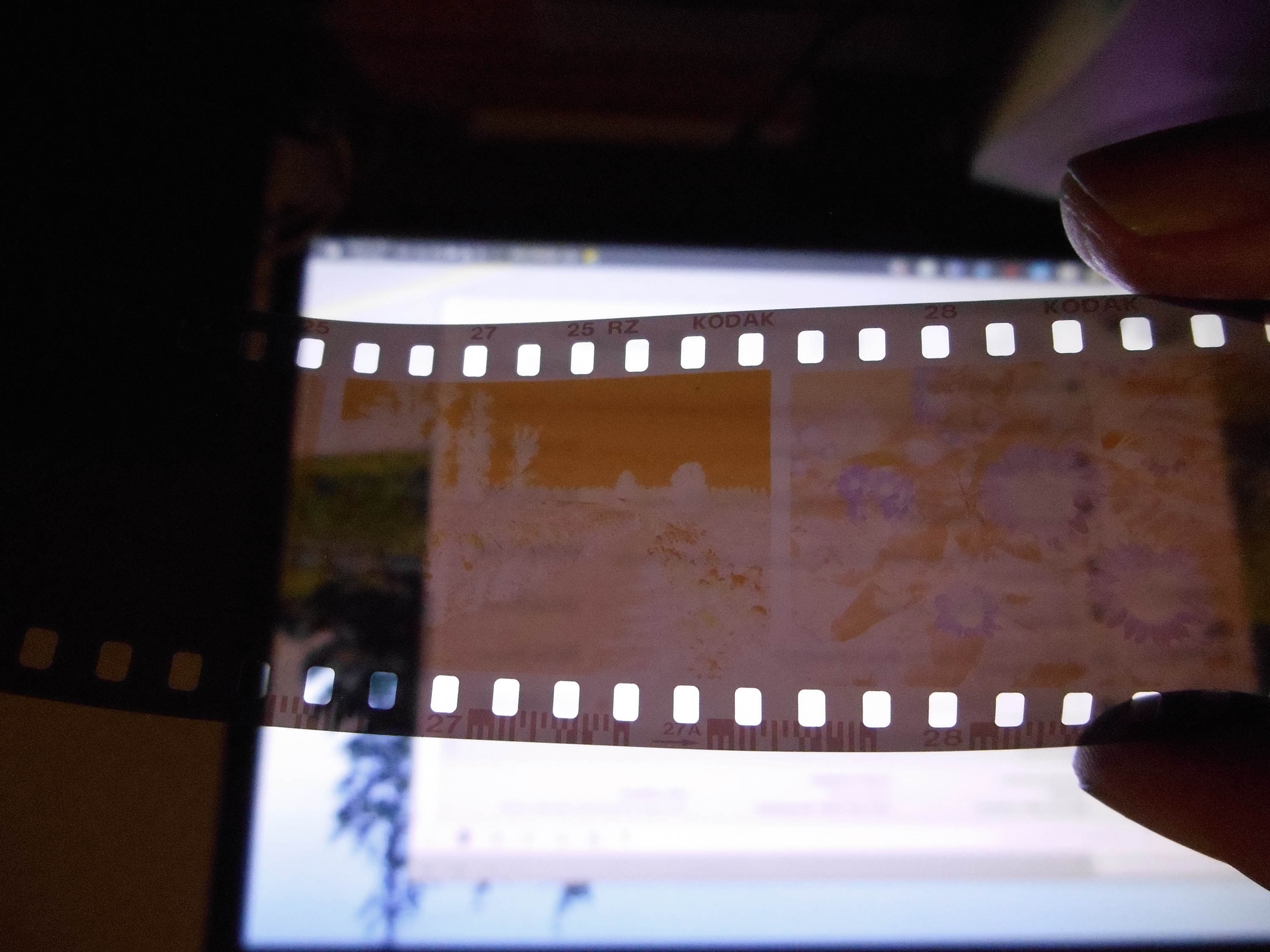

I found 2 rolls of Royal Gold 25 that had been sitting in house temp for over 10 years. These rolls are probably 25 years old. They were cold stored before that. Being a 25 speed film, I'd thought I'd try my luck and shoot them at box speed. Nope. When I got the processed negatives back, they were severely underexposed and fogged of course. Tried scanning one of the shots up on my new film scanner. All I got was underexposed garbage. It saved it as a B&W for some reason, though it showed the scan on screen in color. So much for the shoot I did on the weekend. This is LOMO at its worst. I probably should have shot it at 6 ISO. I used my 50mm 1.4 to shoot with. I wont bother showing the scan, since its useless. But here is a pic of what the negative looked like. Shame I didnt have more of these rolls. I did a comparison over 15 years ago of the new Ektar 100 vs this film. Royal Gold 25 is basically Ektar 25 anyway, just renamed. I dont think that post is still available with the pictures I showed. Im a huge fan of super slow speed films in the 25 ISO range. Both color and B&W.

The negative you show against a backlight doesn't look fogged. The edge markings seem to match the density of the image, so it looks underdeveloped.

I've rarely seen fog this bad. It completely overwhelms the color of the film base.
You can see through the spaces between the frames - it's quite clear. You think there's no chance the developer was bad?

The film was frozen for a number of years, then sat in a bottom dresser drawer for over 10 years in room temps. So it has to be fog, with reduced sensitivity due to age, hence looking underexposed.

It appears, from your picture, that the edge markings are underdeveloped. It looks like the image is underdeveloped. Fog adds overall density and makes the film less transparent - it doesn't reduce the actual density of a developed image or of edge markings. ISO25 film should lose no sensitivity while frozen and then should lose next to no sensitivity at room temperature for 10 years. It looks underdeveloped.
Maybe it's a film that loses its ability to be developed over the years.... Or perhaps it's the screen I'm viewing it on (60 inch tv).

I agree that the edge number look like they were underdeveloped BUT I have seen this before with some old Kodak films even when they were processed correctly.
The base had the same looking fog and when developed correctly in C41 (dev 3min 15sec @38C) they still looked like they had been underdeveloped, like the sample shown above by the OP.

I can't remember if it was film speed specific, I just remember they were always old Kodak films.
It didn't appear to happen too often with old Fuji or Agfa films but it definitely happened with any old Ferrania or Konica made film.
When the processed film was scanned, a correction could be made, and most customers were happy with the results. In fact, most didn't know any different.
