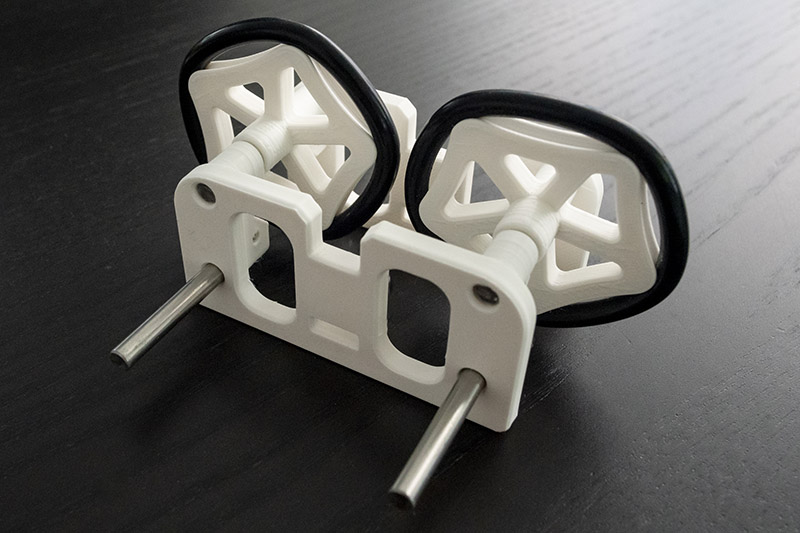

Alan9940
Jun 17, 2006
2,479
Arizona
For those that may be interested, Benoit is developing an additional extension for his rotary processor that "jostles" the tank as it rotates. He's thinking that this will provide more even development vs the smooth rotation of the current setup. If you look closely at the attached, you will see that the two wheels have indentations causing the tank to move up/down as it rotates.
