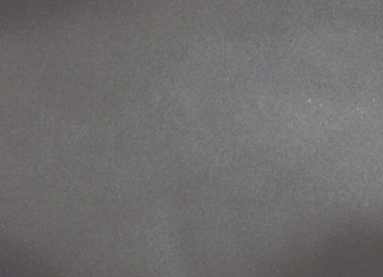

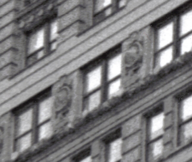

why is tri-x less grainy than tmax400? here are 2 scans at 100%. tri-x and tmax 400 is labeled.Edit: the building is tmax.

Dumb question: are you printing these negs, and seeing TX less grainy than TMAX 400 ? Scanning is a whole set of problems, and doesn't always indicate what the film is really doing.

These are 800 dpi scans of prints. and in the prints i do see that. tmax has such an ugly grain.

You really should compare similar subjects under similar lighting. Open skies or large undifferentiated fields without detail usually make the grain more obvious. Compare the film under the same conditions and situation for a more accurate comparison of grain.
