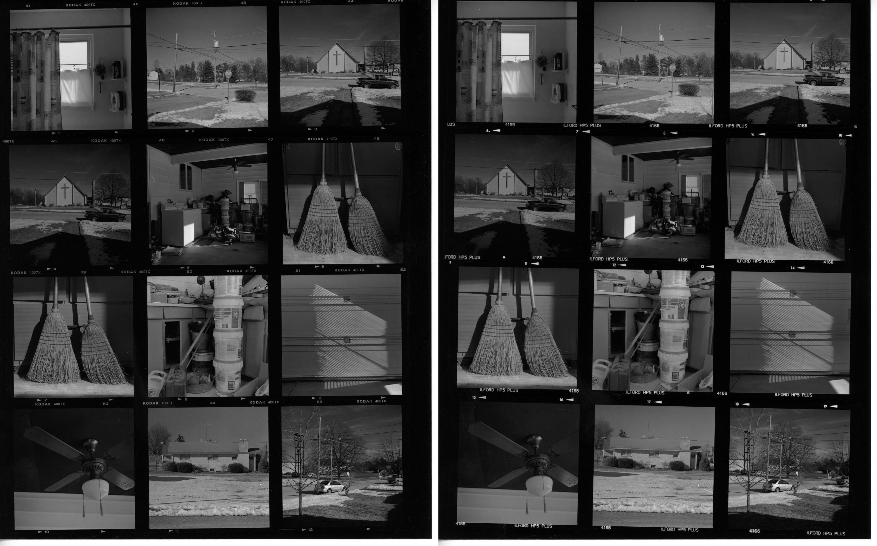

I've been mulling over this Tri-x vs. HP5 thing since my favorite beloved film Neopan 400 (RIP) was rudely discontinued. I've always enjoyed HP5's grittiness, sharpness and speed. But my Tri-x SCANS (keyword, SCANS) have always sparkled in a way that HP5 doesn't. So I finally decided to run a simple test since my best work does get wet printed. I put a roll of each in each of my Mamiya 6 bodies and spent a day this past winter shooting the exact same shot taken just seconds apart with each film. Both films were shot at EI 250. Exposure was determined by a Pentax digital spot meter. Both were developed in ID-11 diluted 1:1. Tri-x for 10 minutes, HP5 for 13 minutes. The resulting negatives were contact printed and here are the results. I believe they speak for themselves. I was shocked to say the least.
Hopefully this will help others who are the way I used to be, constantly searching for the magic bullet, believing there were huge differences between films.

Those contact sheets are dark and muddy looking. They really don't tell us anything. Enlarge some of the photos with the correct print exposure and contrast to make each individually look its best. I like both films, but they're not the same.
startling. So clearly superior!
Have you made comparison enlargements yet?
I'd be interested in seeing a few of those images at full size side by side to look at grain and such. Minus a slight tint variation between the two they look pretty darn close.
I haven't had the greatest of luck with HP5 myself, but I've not tried it in all the developers. Seems like you have got the two pretty close. Nice!
Guys, notice I said SIMPLE test. I did not make the contact sheets contrastier so the highlights/shadows did not get lost. I'm sure I could make some comparison enlargements but none of these pictures are really enlargement worthy really. Just wanted to show that tonality between both films is rather similar. Now sharpness, graininess etc is another story and cannot be seen from this test.

Nice comparison. I can tell more from this than seeing corrected prints with the contrast banged up. It looks like you did a good job of matching the two contact prints. I do think there is a touch more shadow detail and contrast in the Tri-x, but I imagine it is 1/3 stop at most and would disappear in printing. The grain/sharpness issues will be a lot more noticeable in 35mm of course.

This is exactly what I was trying to show. They are more similar than I ever thought. This was a surprise to me. I kind of regret posting this now. I'm sorry to those whose time I wasted, but maybe some APUGers out there will find this of benefit when debating over film similarities and differences.

I got the reference, but don't understand the problem or the need to criticize his sharing this modest amount of information. He did a simple comparison with pretty good control for the use we put film to. I'm surprised people find that bothers them, but apparently some do. I'm used to looking a negatives and contact sheets so maybe that is one difference. I don't mean to fuel the flames, I just appreciate his effort.
I appreciate it too. I always wonder what film I'm going to use next when my favorite goes away. The differences I can see is the HP5+ seems to show more detail in the shadow areas, I looked most at the brooms and the pic with the washer/dryer. Now whether that is really a difference in films, development being different, or just a limitation of the way you did the test, I don't know. From these results, I'd be happy with either.

Thanks Joel. I agree with those who are weary of scanned results, but I did the best I could to reproduce the contact sheets. I also agree that HP5 shows a tad more shadow detail. From these results I will stick with HP5. It's a great film and I like to support Ilford.
