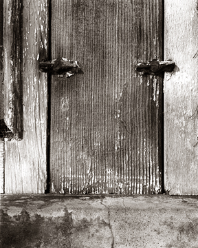

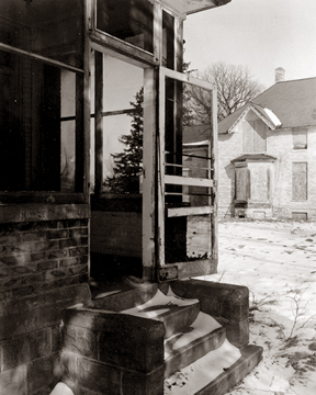

Tri-X 400 Expired 1981
These two are 4x5 sheets of Tri-X 400 that expired in 1981. A little more fog, but it's very easy to just print through it.
Pyrocat-HD developer, printed on Perfecta paper from Fine Art Photo Supply, in Versaprint II glycin developer.
- Thom
