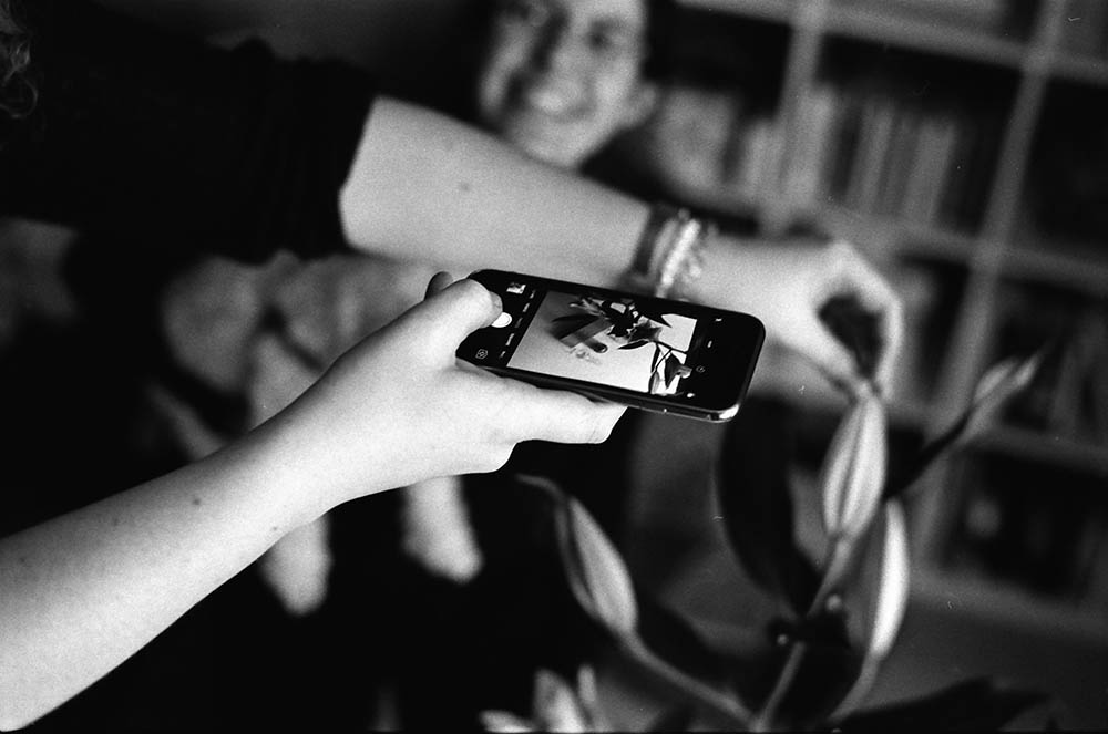

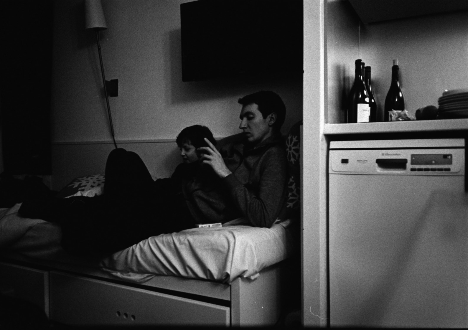

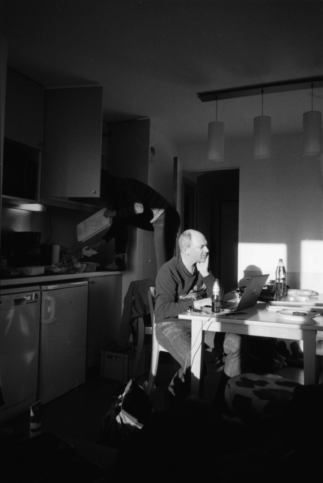

Hello everybody,
ever since I started film photography 2 years ago, I liked the grain of the Kodak Tri-x und how things looked with it in general. I started developing with Rodinal, tried D76, HC-110 and lately FX-39. Since I just don't have the time now to print large amounts of negatives, I usually scan them with a Canon 9000F MkII.
Now every other film looks just fine when scanned, I usually don't adjust anything after scanning, but Tri-X has always shadows so dark that it just looks wrong when compared to my other scans. CHM400 vs Tri-x:
This picture was shot using CHM 400, developed with FX-39. I like how the shadowish details on the left are still visible even though there is bright sunlight.
Here, everything in the left part of the picture is just dark, especially the skin tones. Same camera, but Tri-X (@400), also FX-39.
Do I just have to settle with the fact that Tri-X needs some adjustments? Should I change the developing times, the technique? Anything else?
With HP5+ and HC-110, I like the shadows and details a bit more, even though it still isn't as much detail as I have seen elsewhere (like in this forum).
HP5+, HC110.
I'm just not sure whether I'm doing something wrong when the scans don't look perfect, or printing the darker looking negatives will go as easy as printing Silvermax.
Thank you in advance!

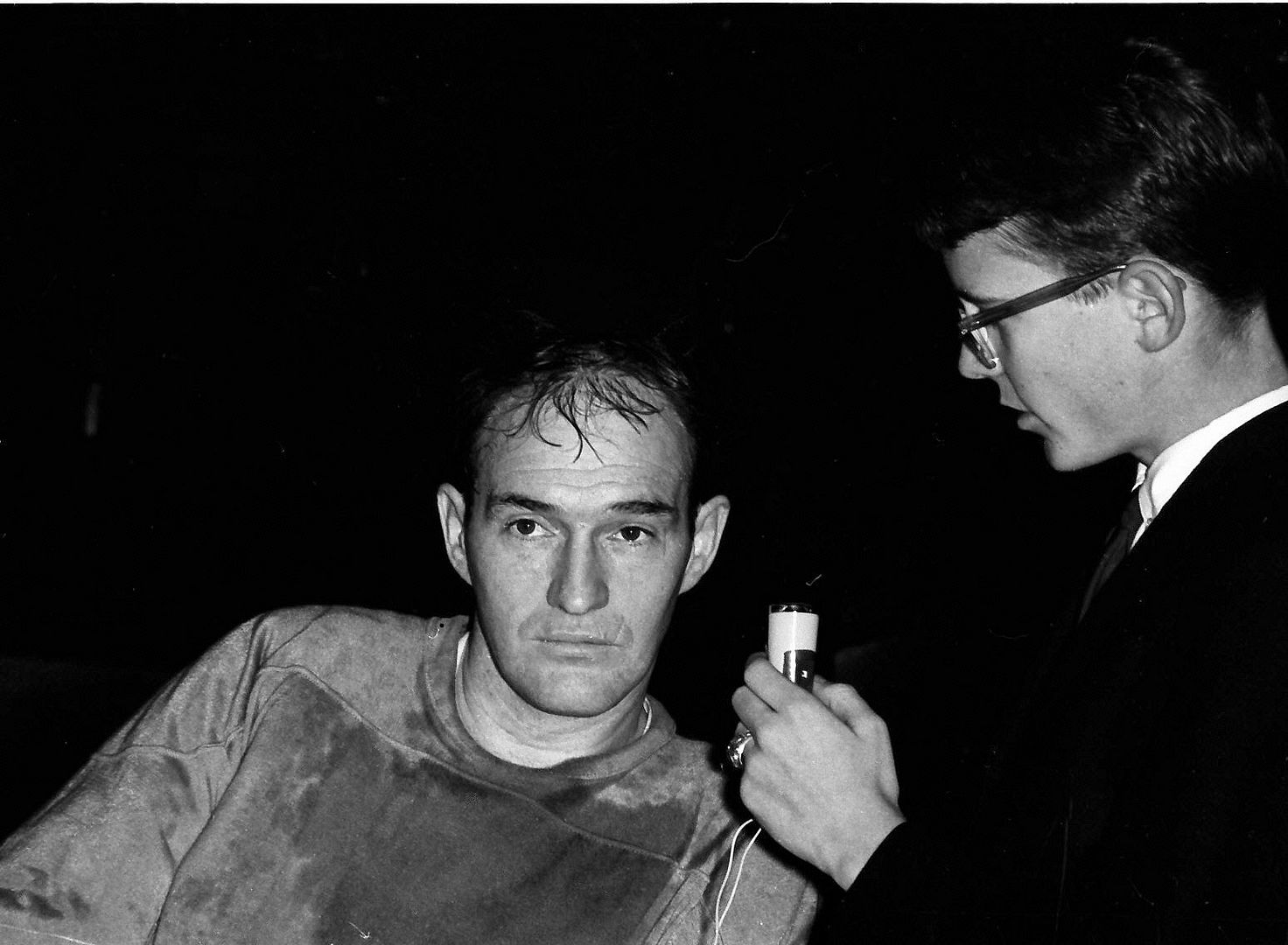

These negs were shot 50 years ago! Tri-X, souped in HC-110 dil. B, and printed conventionally for publication in our highschool newspaper on hard finished newsprint (think Life magazine quality paper). I just grabbed these shots as ones in dark settings with deep shadow, as something representative of Tri-X scanned on Canon 8800F with standard settings, and not altered tonally in postprocessing.

I am just trying to figure what that person is doing trying to climb into the kitchen cupboard!
First, welcome to APUG.
It would be helpful if you could tell us about how you metered those scenes. The first one is very challenging - even if metered perfectly, one would expect to have to dodge and burn (or use the related post-processing tools) in order to obtain a good result.
