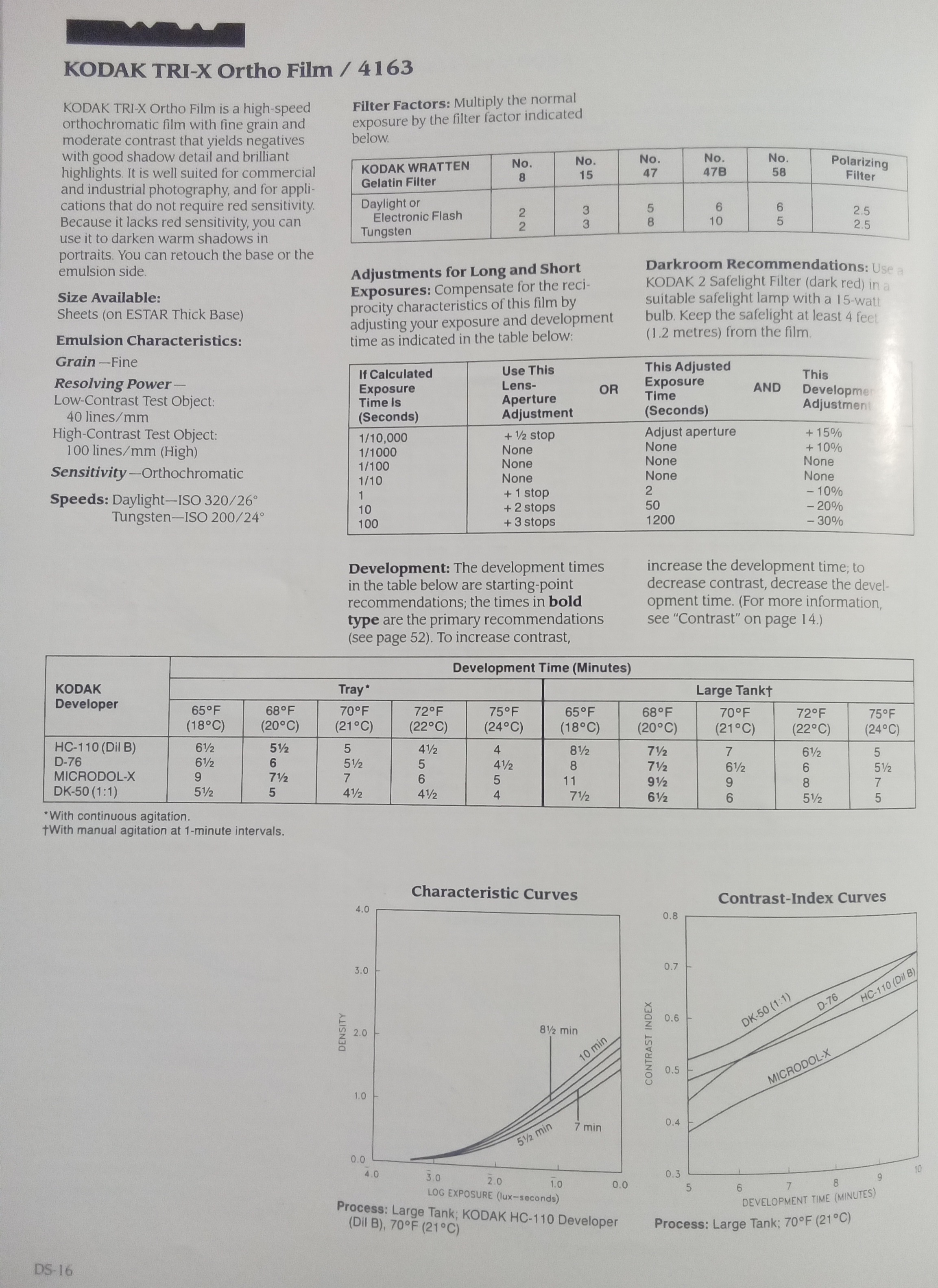

I have a partial box of old 4x5 Tri-X Ortho and I'd like to test it with my LF. I think its expiration is 1983. Here I have Kodak BW darkroom book with me and it tells the developer and developing time.
Since the film is rather old, how much more time I should add to the stated develop time? At 70F, the books says to develop 5.5 minutes with D-76.
I also have a big bottle of T-max developer (1:9). Can i use it instead of the D-76? I figure this is just testing. Hope it is ok.

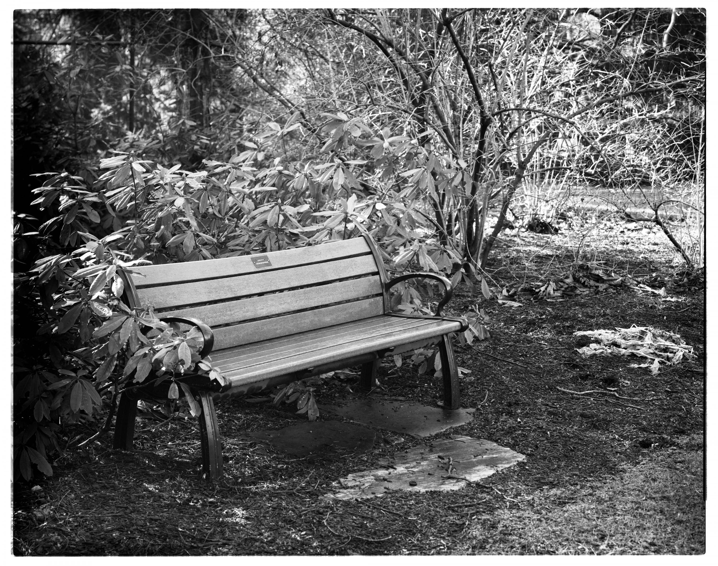

After several years, finally got time to use my Tri-x Ortho 4x5 film. One film in the holder had light leak (over several years). But others are fine. I set the film speed at 25. Probably 50 is better. Used D-76 stock. I actually like the effect of the Ortho film. Very different from the T-max.
Peter Schrager
Jul 19, 2004
4,317
fairfield co
quite nice!!

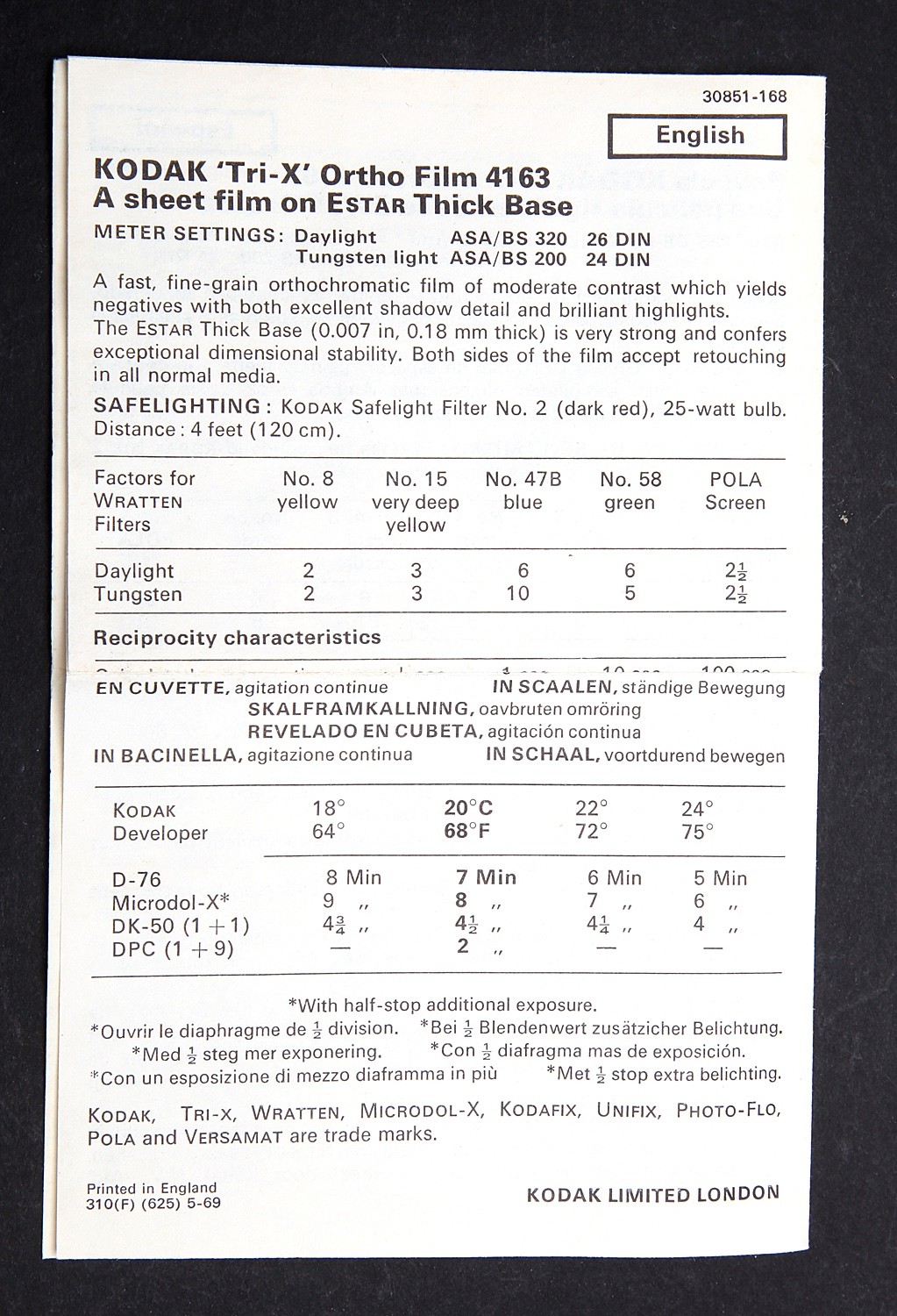

I have just acquired several boxes of Kodak Tri-X Ortho 4163, which came with a 5x4 field camera I just bought. I was beginning to think it wouldn't be of any use but the image above is quite nice. Anyway, I intend to give it a go but I only have Adox Rodinal and 510 Pyro in stock and don't really want to buy anything else until I've familiarised myself with these developers.
Any idea of which to use first? I'll expose the tests at 25 ISO but could do with some guidance on the developing times in a Jobo CPE2.
