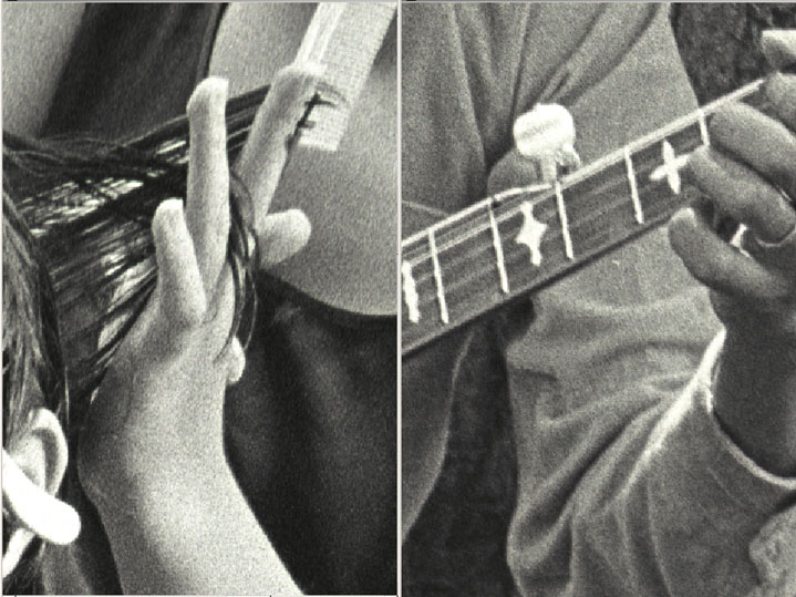

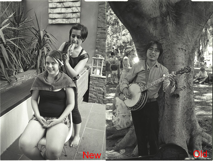

In that case, look out for a member that goes by the name PE (ex-Kodak engineer). In fact he probably won't mind if you send him a PM on the subject. I was just scanning some film so I thought for the hell of it I would scan some 30-year old tri-x and compare it with something I did last month. The most obvious difference is the film base on new tri-x has a blueish/purpleish colour whereas the old tri-x was much clearer. (These were scanned in colour, notwithstanding all the logic that goes into the scanning algorithms)
On the enlarged sections it's difficult to see any profound difference in grain. A more rigorous test under a microscope needed for that I would think.
Again, discounting all the variables such as lighting conditions, lens, developer etc etc. I think the tonal transition on new tri-x is smoother and some might suggest a bit more "plasticy"? Perhaps this is what people are getting at when they suggest old tri-x is more "lifelike"/gritty? I think new tri-x also tames the highlights better, although I was more of an Ilford FP4 user 30 years ago and switched mainly to tri-x about 10 years ago.
Anyway, the world needs both artists and engineers and there is more than a lifetime's analysis ahead of you if your interest is in photography! But beware of myths. I think "old tri-x magic" is one of the myths!

Ah.. Wonderful comparison, Tony! Nothing like real world evidence of actually using them side by side and comparing them. It goes into proving that your results depend a lot more on how you use your materials than what materials you use as far as 'differences' go.

Exactly the helpful evidence I was looking for! I agree there's probably very little visible difference, but then again, I've been doing black and white for a few months. I still have to wrap my head around "tonality," "latitude," "shadow detail" etc., etc. There should be a book that illustrates such concepts side by side.
Great, helpful info. Thanks again.
