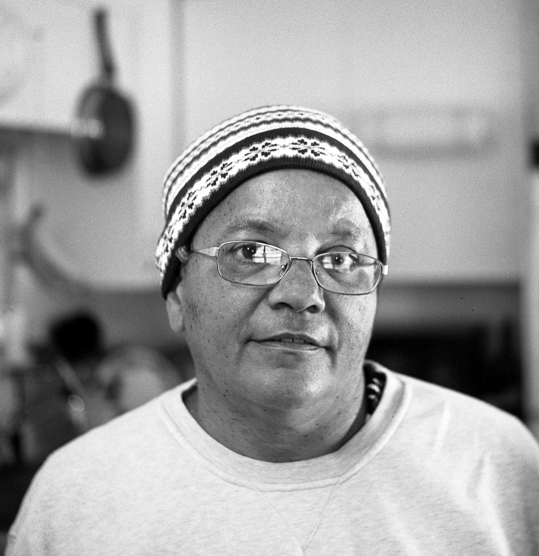

The shot below is more what I like. It was D76 full strength that was accidentally developed using the 1:1 times. This turned out great because it gave the neg a lot more "bite", but the grain tamed down on the wet print :[

Judging from the one time I tried it, and from posted images by others, Diafine is not only low contrast, but dull. Kills the life out of light tones. Not exactly what you praise in your example photo. Just saying.
