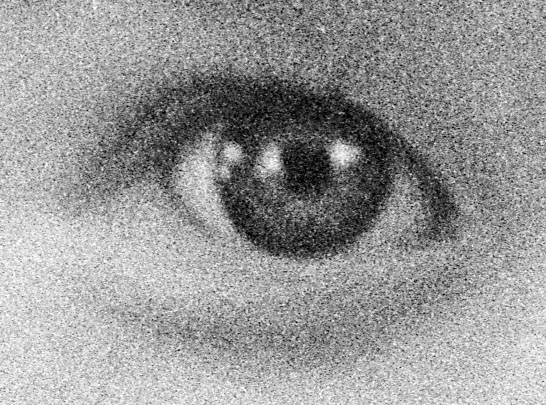

I use Diafine to get high speed. I kind of like the sharp grain of diafine + tri-x. (See enclosed example.) In flat light I have been using Tri-x@1000 and in contrastier conditions where I could use higher asa to lower the contrast with Diafine, I usually use something else than Diafine anyway.
/matti
